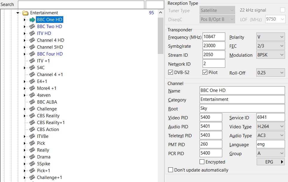

uglyned Posted November 11, 2017 Author Posted November 11, 2017 (edited) I did manage to get Sky out and they swapped the LNB for another hybrid one but the problem persists. Before the Sky install, the signal strength reported to DVBViewer was always around 66%. Now it can vary - when it's on 66% reception is usually fine but it can drop down to 60% at times and I don't understand why. There's a single LNB strapped to it, receiving 19.2e and that works remarkably well for a zone 1 dish. Then the reception on the Freesat LNB drops, the 19.2e one remains good. But behaviour is really odd. Yesterday, for example, I had no reception on any channel. Recording BBC One HD, just no reception.But when scanning the 10847V transponder in Trandedit, the results I get are Bloomsberg HD, COLORS HD and DAYSTAR HD. I looked them up, and they're on 11685.5V.I'm guessing that after a while, reception will come back and the correct channels will start showing up.I don't think this is a signal strength thing, I think something strange is going on. Can anyone shed any light on it?!It's not just that transponder either.Currently scanning 10714H I'd be expecting Channel 4 channels but I'm getting Clubland TV amongst others. That's on 11552.75. If anyone has any suggestions that would be well received. When the installer came to look into it, he swapped the LNB because the old one, he said, was 'dead on transponder 41'. I suspect that the LNB was not faulty, but this was a symptom of whatever the underlying issue is. Edited November 11, 2017 by uglyned Quote
Derrick Posted November 11, 2017 Posted November 11, 2017 I have no idea what's going wrong but the Transedit examples could be explained by wrong IF-band selection in the LNB. A universal LNB works with LOF1 (low band) = 9750MHz and LOF2 (hgh band) 10600MHz. 10847V is obviously a low band transponder. IF=10847-9750=1097 [MHz] this is the intermediate frequency that arrives at the tuner and yields a scan with the BBC HD services. If for some reasons the LNB is not in LOF1 mode but LOF2 mode 1097MHz IF translates into 1097+10600= 11697 [MHz] On 11697V is no transponder listed. The tuner will lock to the next available frequency if not too far away. -> 11686V. Quote
uglyned Posted November 11, 2017 Author Posted November 11, 2017 35 minutes ago, Derrick said: I have no idea what's going wrong but the Transedit examples could be explained by wrong IF-band selection in the LNB. A universal LNB works with LOF1 (low band) = 9750MHz and LOF2 (hgh band) 10600MHz. 10847V is obviously a low band transponder. IF=10847-9750=1097 [MHz] this is the intermediate frequency that arrives at the tuner and yields a scan with the BBC HD services. If for some reasons the LNB is not in LOF1 mode but LOF2 mode 1097MHz IF translates into 1097+10600= 11697 [MHz] On 11697V is no transponder listed. The tuner will lock to the next available frequency if not too far away. -> 11686V. Thanks Derrick. But as you said earlier in the thread, we think this is not a universal LNB. It's specific to Sky Q - something you refer to as an FBC tuner. From what I've read on other forums, it's called a 'hybrid' LNB and is supposed to auto detect the type of tuner that's on the end of it and adapt what it sends accordingly. Just, for some reason, something appears to be going wrong. Quote
Derrick Posted November 11, 2017 Posted November 11, 2017 I was referring to DVBV. I doubt if there are settings for a FBC tuner and a wideband LNB. What are your LNB-settings? Quote

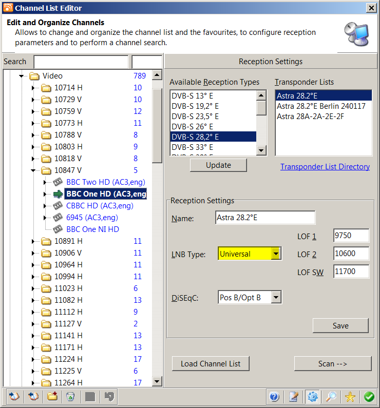

uglyned Posted November 11, 2017 Author Posted November 11, 2017 (edited) Thanks Derrick. Here's a screenshot of the lnb settings, I also attached a support.zip in case you can help. The server that the RS is installed on is not used for watching TV so please ignore anything around rendering, it doesn't usually work but it's not an issue, as I normally access the PC through RDP. Edited November 12, 2017 by uglyned Quote
Derrick Posted November 11, 2017 Posted November 11, 2017 I don't see any LNB settings. You'll find them in the channel editor Quote
Derrick Posted November 12, 2017 Posted November 12, 2017 Not quite. The settings are well hidden (Ctrl+R) Quote
uglyned Posted November 12, 2017 Author Posted November 12, 2017 Ah right - thanks yep I found them now. To save me copying, pasting, saving, uploading - they're identical to the screenshot you posted - LNB type 'Universal', and the same numbers in those boxes on the right. Quote
Griga Posted November 12, 2017 Posted November 12, 2017 44 minutes ago, Derrick said: The settings are well hidden There is a main menu item (TV/Radio -> Reception Settings/Channel Search), a gear wheel tool button in the Channel Editor (bottom right) that provides a hint ("Reception Settings"), a help button that opens the corresponding Wiki article, a Reception Settings context menu item... ...and there is a "Support for visual impaired users" checkbox on Options -> Extended Quote

Derrick Posted November 12, 2017 Posted November 12, 2017 @uglyned, you have to connect the tuners to an universal LNB. A wideband LNB transmits the entire frequency range (low and high) to the tuner. No switching frequency, no 22KHz anda single LOF. e.g. http://www.inverto.tv/lnb/213/wideband-40mm-lnb-with-horizontalvertical-ports The IF frequency range is 300-2300 MHz which won't work with your devices (normally 950-2150 MHz). Quote
uglyned Posted November 12, 2017 Author Posted November 12, 2017 34 minutes ago, Derrick said: @uglyned, you have to connect the tuners to an universal LNB. A wideband LNB transmits the entire frequency range (low and high) to the tuner. No switching frequency, no 22KHz anda single LOF. e.g. http://www.inverto.tv/lnb/213/wideband-40mm-lnb-with-horizontalvertical-ports The IF frequency range is 300-2300 MHz which won't work with your devices (normally 950-2150 MHz). Thanks Derrick - but it's a hybrid LNB, so it's supposed to autodetect the tuner type and respond correctly. I realise this is a really strange one, and thanks for your time and effort in explaining. You are correct - when the subscription runs out, it's likely that I'll put the old universal LNB back up - I did keep it. I have no doubt that this will resolve the issue, I just wanted to try and get them both working together. Thanks again. Quote
