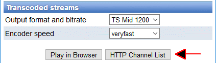

This button exports a M3U playlist that contains URLs for transcoded channels:
The button only appears if you select a channel for playback.
