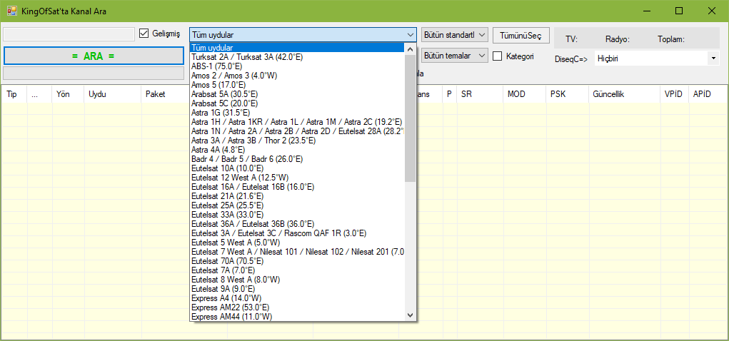

We all know that there is a few frequencies that fail to scan while doing a satellite scan, i used to use a tool that grabs the up to date channel list from Kingofsat.
It was a Turkish tool that allow you to chose your satellite then it grabs all the channels from Kingofsat and export it as ini ready for importing at DVBViewer
Sadly this tool doesn't work any more , any one have any idea how to do it ?

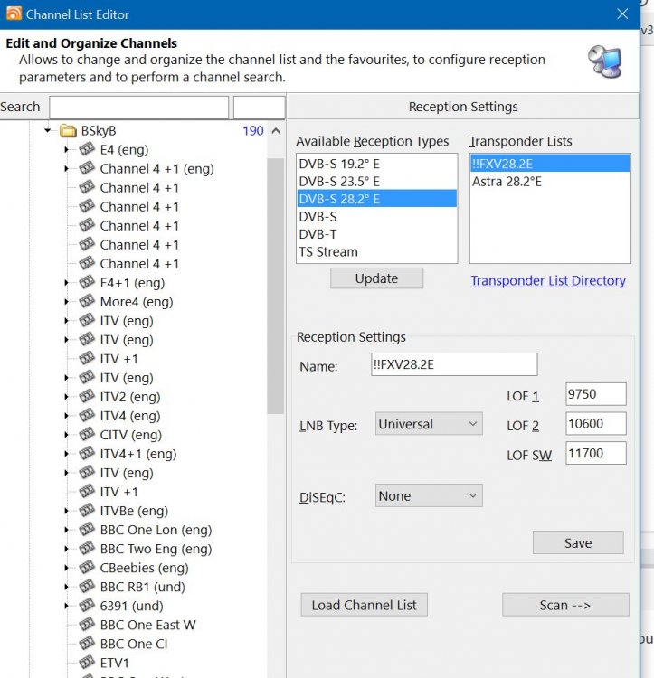

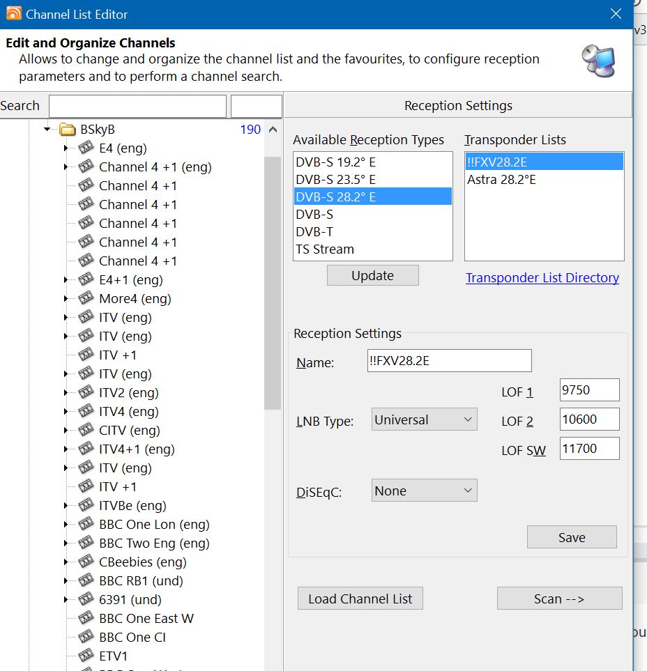

you can download the .ini file from Kingofsat and dump in the folder   ProgramData\CMUV\DVBViewer\Transponders
then select which list to use via channel list editor
Dear fxv1
Thanks for your feedback, but i meant ini file for Channels not the Transponders
