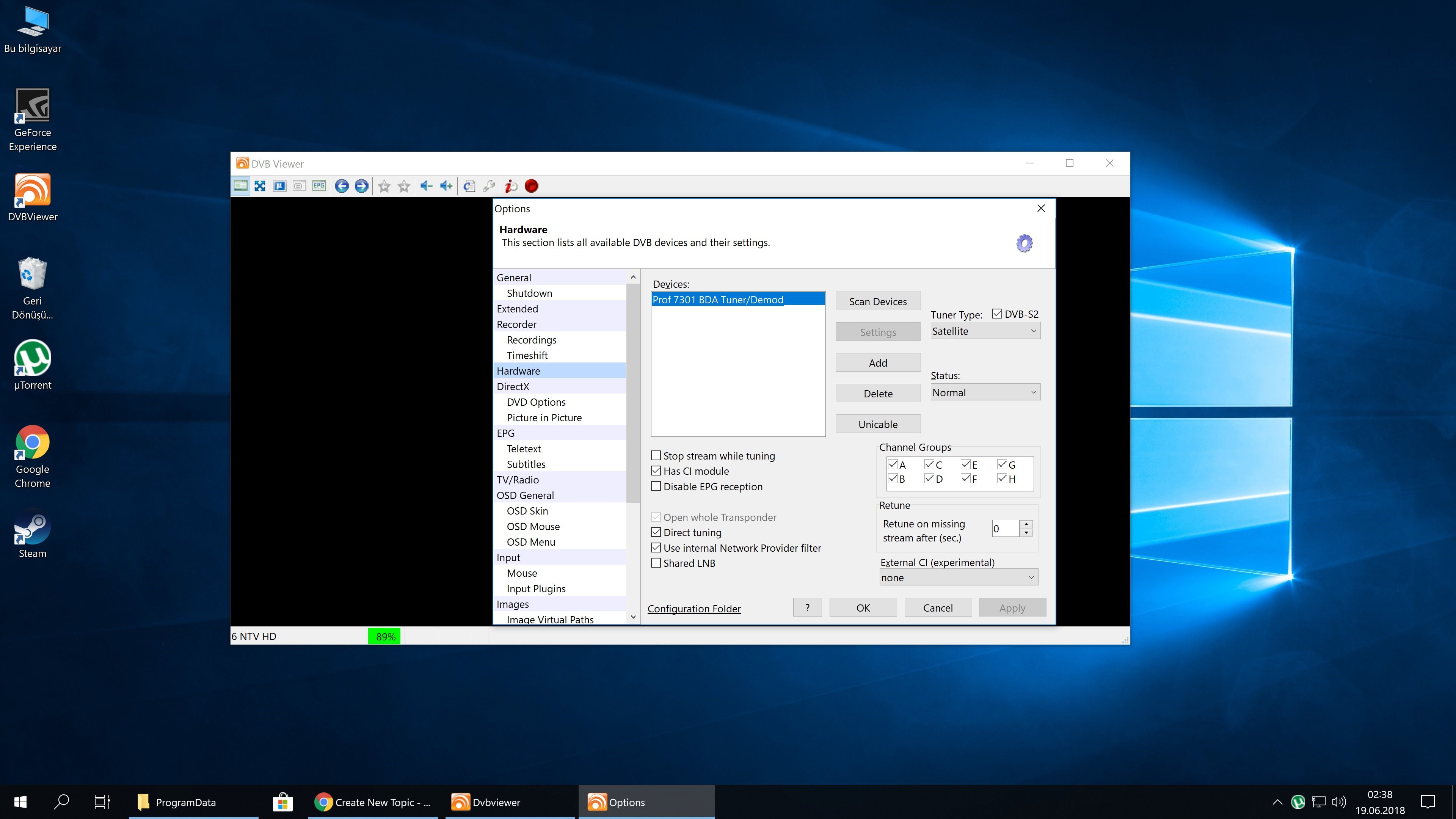

I installed the tv capture card driver, direct 9x and codecs. I can see the %89 signal. I even copied the DVBViewer program folder and CMUV folder that i have as back up but cant have video or audio since I reinstalled windows 10 pro

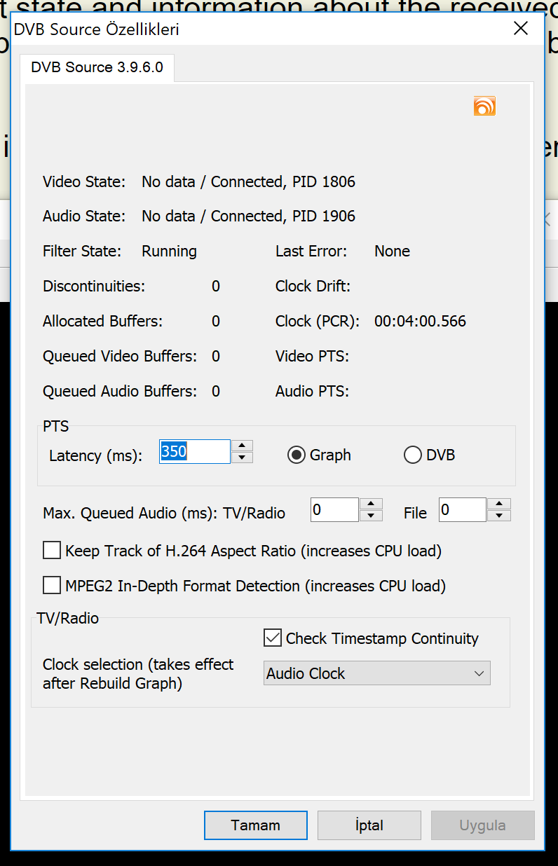

Please also have a look at the DVBViewer Filter Property Page. What does it show?

Tv card and DVBViewer worked fine on windows 10 up to date perfectly. I just formatted and reinstalled windows 10 and before i do that I saved a back up of DVBViewer program files and CMUV folders.
I just deleted Device Parameters as it's written on the last link you sent to me but then it gets everything worse, i don't even get the signal anymore, and tv card does not work at all when i try to change the tv channel or rescan the tv card on DVBViewer hardware menu.
DVB Filter: 2032004908_EkranAlnts.thumb.PNG.7f0a04e6faeead07bd0229b12b2517c7.PNG
