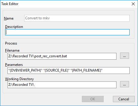

So in the task I set:
Z: is a network drive. The recording service runs as my own user to be able to access the network drive.
The script I have made is then.

07.07.18 23:10:01.795 TProcessTimer        Process Params   "C:\Program Files (x86)\DVBViewer\" "\\ds412\DS412\Recorded TV\Deadline\2018-07-07_22-25-03_Deadline.ts" "\\ds412\DS412\Recorded TV\Deadline\2018-07-07_22-25-03_Deadline"
07.07.18 23:10:01.795 SetStandbyBlock      TProcessTimer
07.07.18 23:10:01.795 TRecordingEngine     AddReference     TProcessTimer: 1
07.07.18 23:10:01.795 TWinApp              Execute          Z:\Recorded TV\post_rec_convert.bat
07.07.18 23:10:01.795 TWinApp              Working Directory Z:\Recorded TV\
07.07.18 23:10:01.795 TWinApp              CreateProcess Error 2

Apparently the user that executes the command (SYSTEM?) can access the folder if I change to UNC paths (as suggested in your link) in the task setup. So it works now.
Thanks again!
