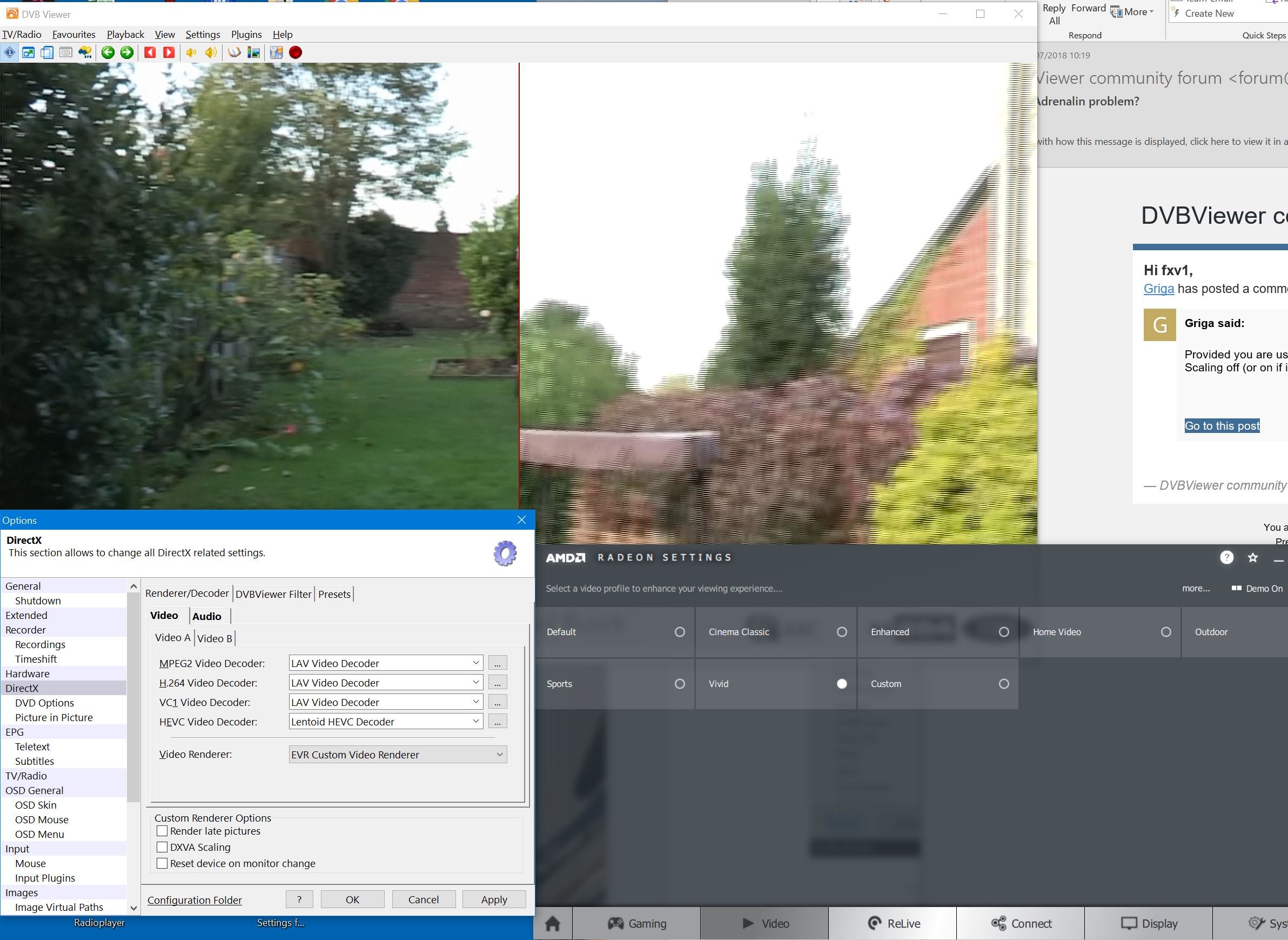

When trying to change from Default to another option( tried most of them ) in AMD Driver Adrenalin I get this strange effect that the default part is fine but any other choice makes the right hand side zoom up. I have changed codecs but that did not help. This has only recently started happening...I have upgraded to W10 1803 and also to Adrenalin 18.7.1
This happens both on Freeview and Freesat transmissions.
Any help with this issue appreciated.

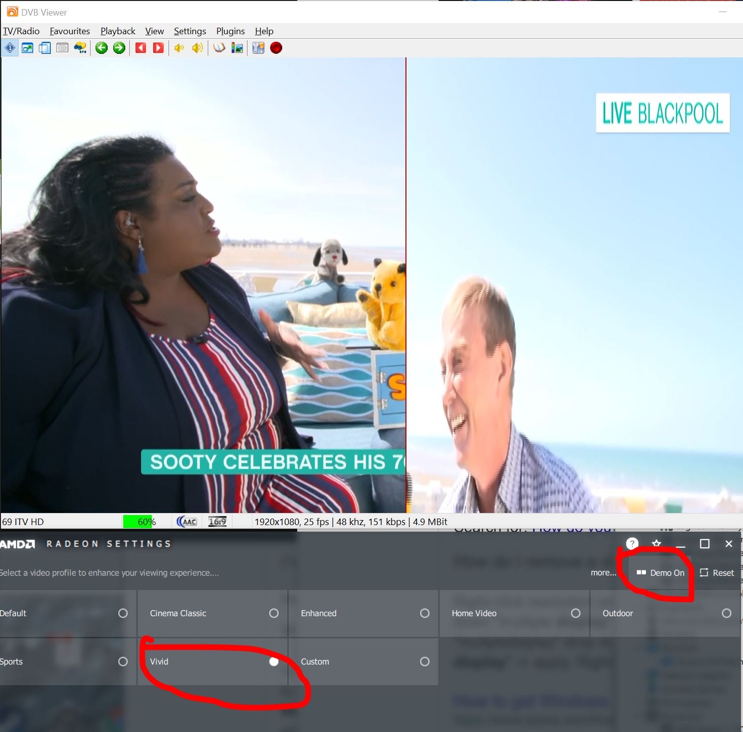

If I use "vivid" for video settings it starts ok for a couple of seconds then zooms  to a larger value. Changing the zoom settings in DVBViewer still has no real effect...back to default for now. Custom seems ok but changing custom brightness is a problem.

Provided you are using Options -> DirectX -> Video Renderer -> EVR Custom Video Renderer: Does DXVA Scaling off (or on if it is off) have influence on the issue? Or selecting the EVR Enhanced Video Renderer?
dxva.thumb.JPG.a003ebf9908ab8754d9fcd9cb17abc5f.JPGTurned DXVA Scaling off, no change
Also using EVR Custom and Enhanced video renderer....same issues applies.
