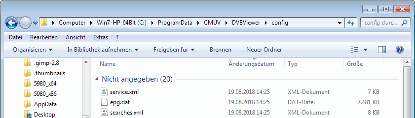

The DMS configuration files including the svctimers.xml are located in C:\ProgramData\CMUV\DVBViewer\Config. I've never seen something stored in an "all_users" directory.

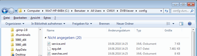

Griga. He may be using Windows 7 Like I do. In Windos 7 the files are stored in c:\Users\All Users\CMUV\DVBViewer\Config\
rco133
Seems to be the same as C:\ProgramData\CMUV\DVBViewer\config. I get this path under Windows 7 by opening the DMS options -> click Configuration Folder (opens an Explorer window):
If I copy your All Users path to the address bar the Explorer shows the same directoy :
However, if I click the All Users parent directory in the address bar, I don't get there, but to the ProgramData directory.
So I guess All Users doesn't really exist, but is mapped to ProgramData for compatibility reasons. This internal mapping / renaming of directories performed by Windows can be pretty confusing :wacko:
