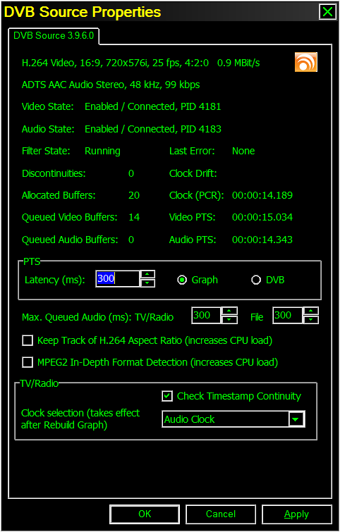

Griga Posted September 22, 2018 Posted September 22, 2018 Please provide a screenshot of the DVBViewer Filter property page when there is no audio. Quote
Griga Posted September 23, 2018 Posted September 23, 2018 That looks pretty well (except the colours ). Obviously the DVBViewer Filter detects the audio format correctly and passes the data without errors to the decoder. I guess the issue is caused somehow by unscrambling. There are two AAC types in the DVB sphere that must be distinguished (LOAS/LATM and ADTS). Usually audio decoders need to be informed about the type before they start decoding. That's why DVBViewer performs a format detection in case of AAC before TV/Radio playback starts. If it can't determine the format within a timeout of 3 seconds it gives up and reports LOAS/LATM as default to the decoder, which is wrong in this case. This may happen if the CI/CAM delays AAC unscrambling for some reason. This could explain the issue. However, in my experience the LAV audio decoder 0.72 is clever enough to switch over to the correct handling later (after playback start) even if it initially gets wrong information about the AAC type. With other words: Here it decodes ADTS AAC quite happily if I let DVBViewer purposely pass the wrong information to it, in contrast to the MS decoder that only produces silence. This means, it should work in your case with LAV, or the theory above is wrong Anyway, who really knows... I've enhanced the audio format detection now by letting DVBViewer stop playback, reconnect the decoder, pass the correct information to it and restart playback if the format is only detected after playback start. I can provide a test version, if you like to try, which may or may not work... Quote
