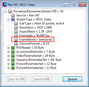

I think I know what you mean. The ticker of REN HD shows it quite clearly: A slight vertical bobbing if I use the LAV video decoder. Most likely this is the reason (Header Info function of the TransEdit Analyzer):
It's quite unusual for HEVC HD. The LAV developer told me some time ago that his video decoder doesn't really support it. Most of the HEVC stuff uses progressive mode. I get the same result without or with hardware accelerated (DXVA) HEVC decoding by the graphics card (NVIDIA Geforce GT 1030).
I've also tried the Cyberlink HEVC decoder without HEVC hardware decoding. The result was much better: The bobbing could hardly be seen.
Thank you very much! This is the reason. I've heard that the last version of MainConcept HEVC decoder gives the reasonable result as well, but I haven't tried it yet. Thank you once more.
