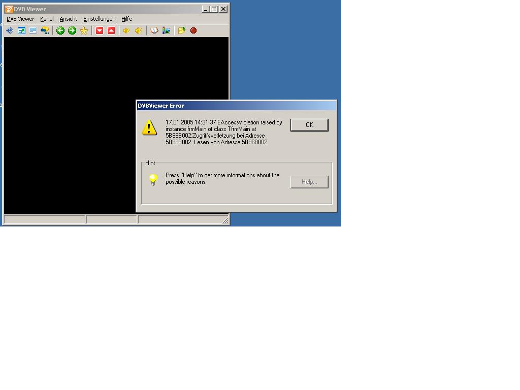

budd Posted January 16, 2005 Posted January 16, 2005 hi@ My 1st error was this -> http://lolomm.de/~budd/dvb.JPG After that i searched a bit in this board. Then i installed new driver v. 4.3. After reboot my win freeze on winlogon =( So i have to remove the new driver. And now i dont know what i should do i need help. sry4 my english :> Quote

Guest Lars_MQ Posted January 16, 2005 Posted January 16, 2005 Hmm why does he say AppVer 1.9.7.200 in the error message? which version of the DVBViewer do you use? Quote

Klausing Posted January 17, 2005 Posted January 17, 2005 This is no setup.ini of an uptodate Pro Version ! You have 2 problematic Decoder : Nero Digital Audio Decoder and ffdshow. Nero you can unregister with Radlight Filtermanager. For ffdshow exist here a script in the board which solve some problems. Steffen Quote

budd Posted January 17, 2005 Author Posted January 17, 2005 i deinstalled sp2. now the newest driver+DVBViewer te are working BUT look at the pic... i think i will reinstall my comp Quote
budd Posted January 17, 2005 Author Posted January 17, 2005 re@ i have formated my comp and install win+apps again. I think i found the error. When i installed goardion knot codec pack v.9 the DVBViewer do nothing. then i deinstalled ffshow alpha 2004-10-12. now it works. Quote
