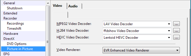

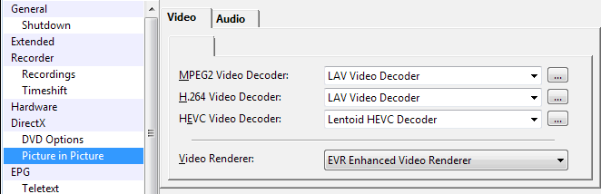

vor 2 Minuten schrieb Etienne:
can i set the video codec in fixed way for PIP somewhere ?
Settings -> Options -> Picture in Picture (as DirectX subitem).

ATI HD 4300/4500 here under Windows 7. Working well for HD in the main window and PiP in window mode (except if the main window is located on a second monitor). However, in full screen mode the GPU seems to be overloaded.
After trying this and that...
If you have a poor GPU like the one in old ATI cards, the secret key for fluent double HD playback in the main window and PiP (even in full screen mode) is load balancing. That means, don't put all the load for decoding two video streams on the GPU, but also let the CPU do something.
Main window video should be decoded by the graphics card hardware (e.g. by using the LAV video decoder configured for DXVA2 native on its property page), and PiP video by software, provided the CPU is fast enough for it. I'm using the old ffdshow pure software decoder. It works pretty well this way and also solves PiP problems on the second monitor.

So best settings for my machine for dxva is Cyberlink + Cyberlink . I have try under w10 , w7 and xp with Overlay on same machine.
Then i have loaded ffdshow Video decoder (no dxva setting) , set this codec for PIP, and yes no more stuttering.
But my CPU rise up to 40 % in this case, it's a old dual core E6500 ... This is not ideal situation...
But I keep this setting because PIP is only for temporary viewing.
