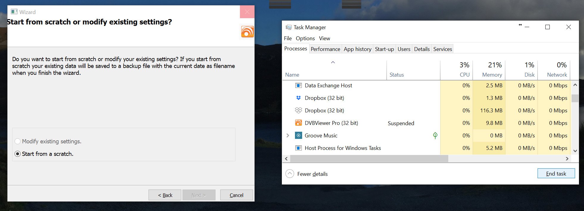

It is almost impossible to do it. The software is getting frozen just in the first configuration . It is not running in debug mode. Support tool is not working (maybe because the DVBViewer is running in the background). I cannot kill the task in the task manager, it appears like suspended when try to kill it but not possible to close it except if I restart windows.
Sorry, maybe I am doing something wrong. The reality is that I have installed DVBViewer 3 or 4 times, whatever I replace something in my pc or in my second device and I have never  had this problem.
Thank you,
Rigo
Adding the only thing I can get. When I click "Next", the software keep freeze.

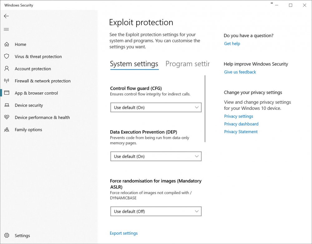

How is ASLR (Address Space Layout Randomization) configured in your system? Forcing it for all application may cause such issues. Please read more about it here and check the settings shown in this image.

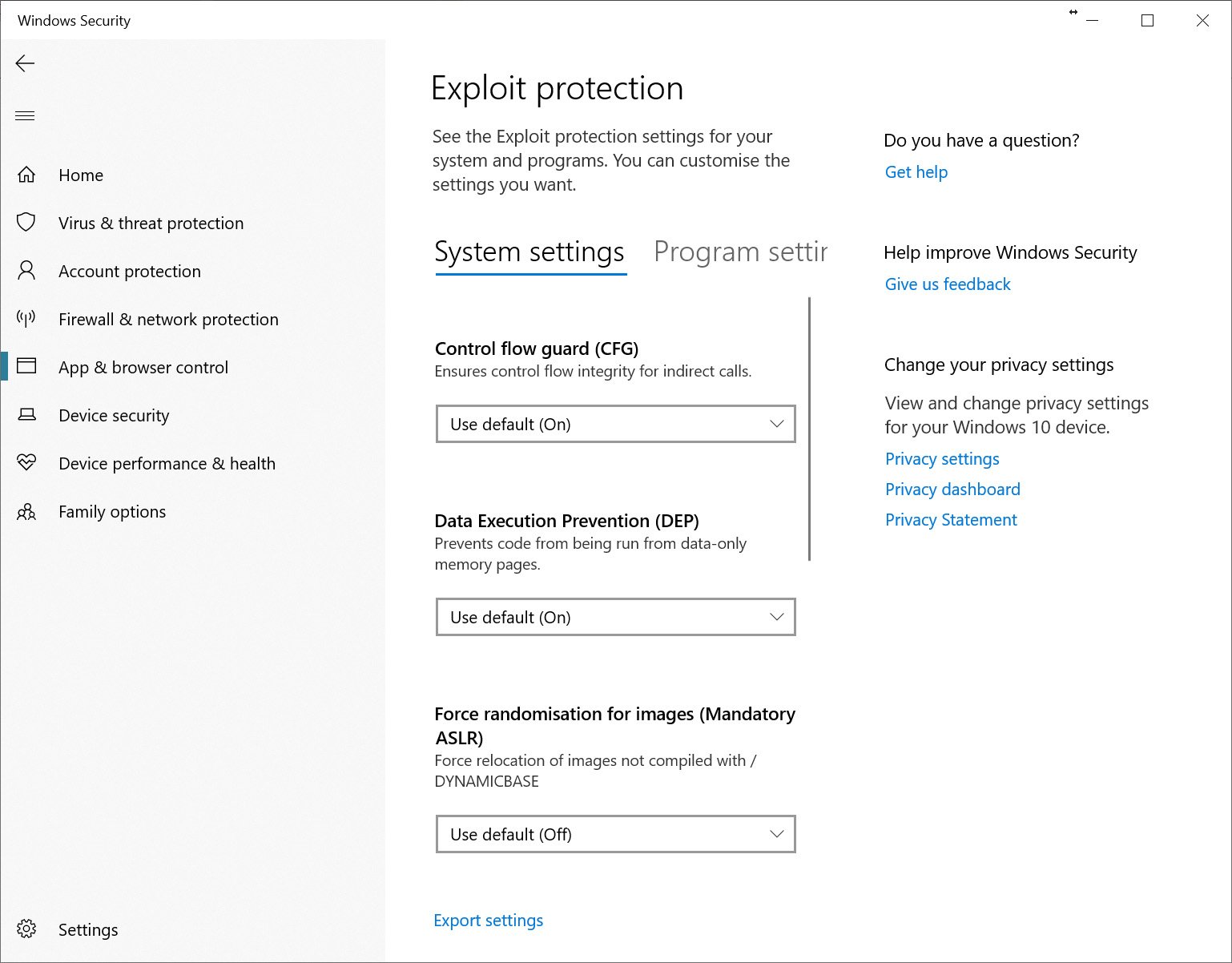

It is off. I have not modified anything from default windows configuration. Just installed windows and in a very fresh installation, try to install DVBViewer pro. I tried with the last 3 version with the same result.  I have been searching in the chat about possible similar problems but I cannot find anything.
