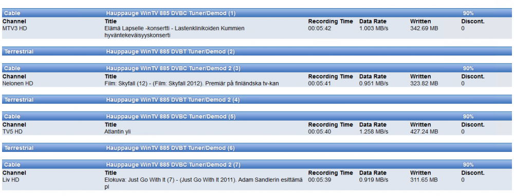

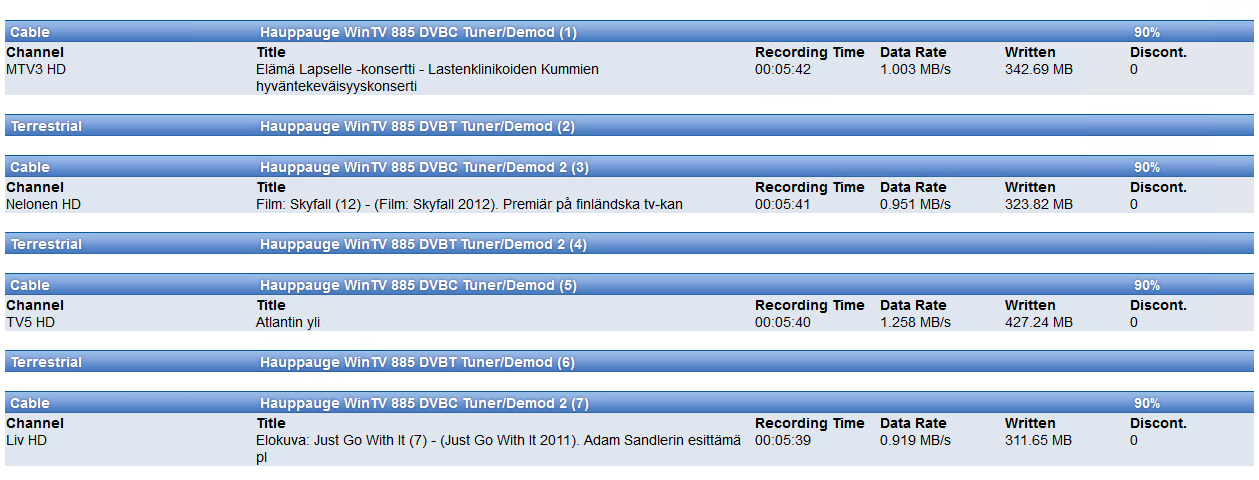

It seems to work and all tuners can be used. But it was not easy to get it working at least for now.
First things, card might not work with every motherboard, particularly my current PC (X79A-GD45 + 3960x) it didn't really work. Most of time it wouldn't start up due to "Insufficient system resources exist to complete the api", sometimes disappear after few minutes and sometimes it worked with WinTV, but never with DVBViewer. Of course this wasn't clean Windows install but I even upgraded from 1709 to 1903 and same errors.
This week I built my new PC (x570 taichi + 3900x) and it was recognized and worked with WinTV everytime so far. DVBViewer still didn't work.
I tried TransEdit and it was working and then found out why it didn't work with DVBViewer.
 I had scanned channels with different tuner (Astrometa USB stick), turns out this had caused DVBViewer to use wrong symbol rate
and modulation (6875 / QAM64 while correct was 6900 / QAM256).
I suppose this was "close enough" for Astrometa while this is more strict.
With that fixed, now all seems to work:
Hope this can be helpful for someone.
