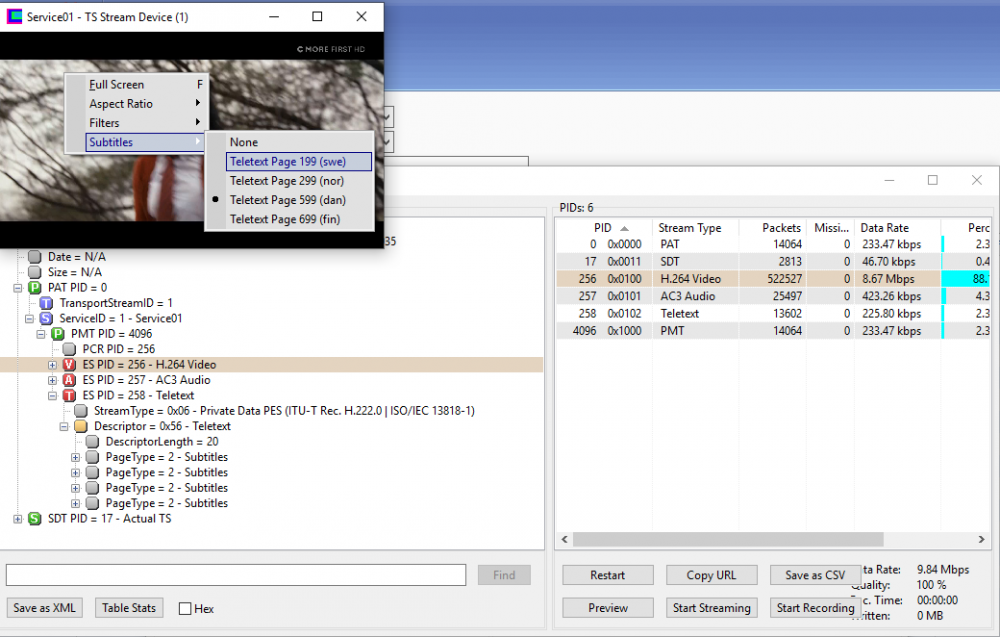

Lars Andersen Posted September 11, 2019 Author Posted September 11, 2019 Hi again, Thanks for looking into it. More info comes here. I have placed my url in transedit now and you can see result in the screenshot. So we are talking teletext. When I choose Preview it is possible to see the different Subtitles. But even when I select them they do not show up in the picture. Nothing? I know for sure it is working within the VLC player. Quote

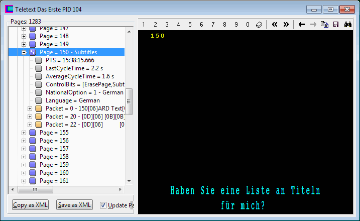

Griga Posted September 11, 2019 Posted September 11, 2019 Can you upload a sample somewhere? Best would be to record it with TransEdit while teletext subtitles are active: Right-click the PID list in the Analyzer -> Select All. Click Start Recording -> wait about 30 seconds -> Click Stop Recording Settings -> Analyzer -> Output Directory tells you where the target directory is. You may also want to inspect the teletext data by right-clicking the teletext stream in the PID list -> Teletext/Subtitle Analyzer. Data that is flagged as subtitle page should be displayed like this: Quote

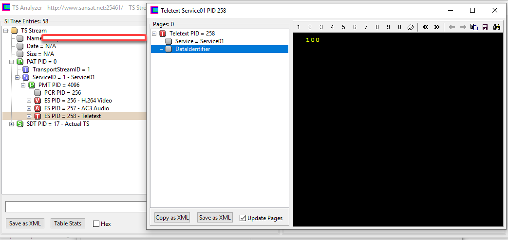

Lars Andersen Posted September 11, 2019 Author Posted September 11, 2019 Samle is uploaded here https://1drv.ms/u/s!AhJqU5lM270KgZNG7IiT5IZklDmbLQ?e=3ZBcx6 This is from the subtitle analyzer. Page is only blank....? Quote
Griga Posted September 11, 2019 Posted September 11, 2019 Looks like they are doing some non-standard stuff.... DVBViewer and TransEdit expect the teletext data packets to begin at a fixed offset. The stream does not comply with it. However, it is not so difficult to calculate the variable offset. This looks better now: But I don't understand why there is a hex page number 1FF. According to the PMT content it should be 199. Usually pages with hex digits are not intended to be visible for television viewers. And why is the page not flagged as subtitle page? Further investigations are required... do you have a TV set where you can look up the page numbers? If I can make it work, you will have to test an updated DVBViewer version... so stay tuned Quote
