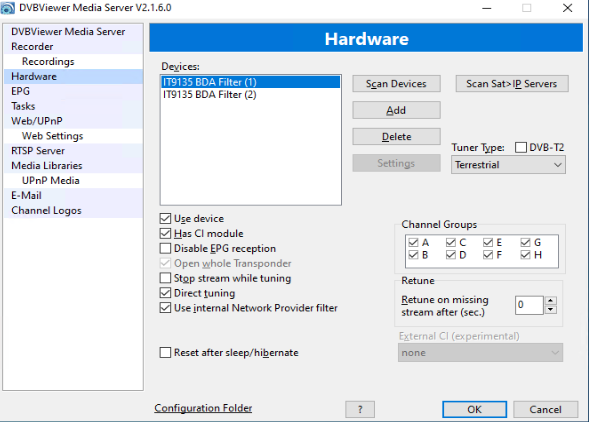

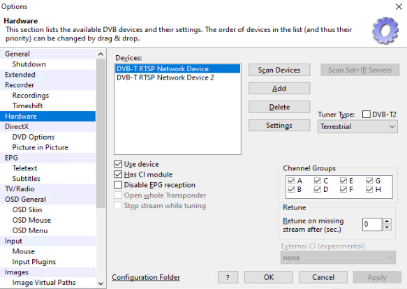

I have been using the DVBViewer/DVB Media Server for some years now and I am a satisfied customer to this excellent family of products. I am using two AverMedia Volar 2 HD USB sticks for HD TV reception within a Windows 10 box and everything was running fine.
After updating to the latest versions (6.1.6.0/2.1.6), I can only use one of the two tuners within DVBViewer! If I schedule, however, two simultaneous recordings belonging to two different DVB transport streams (forcing both USB tuners to function simultaneously), I can record any content just fine! Therefore, on a hardware/driver level, the USB tuners work out fine.
It seems that the interoperability between the two products has been somewhat lost or disrupted.

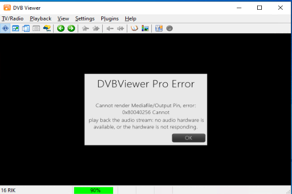

I attach the hardware settings of both DVBViewer and DVB Media Server, along with the error message during DVBViewer startup. Also, please note that any firewall has been disabled.

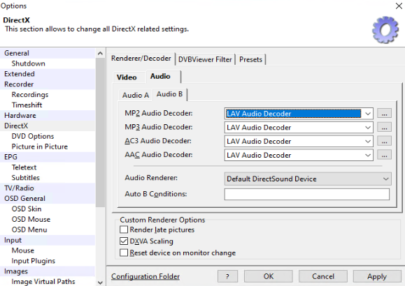

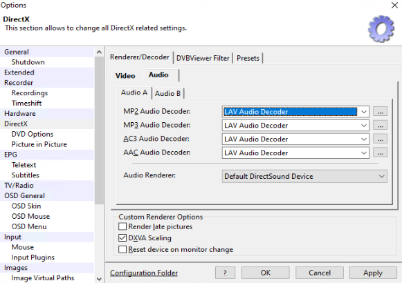

The error message in your screenshot above is related to audio hardware (see Options -> DirectX -> Audio -> Audio Renderer). It is created by the DirectShow playback system. The text does not originate from DVBViewer, but Microsoft. As far as I can see It is not related to DVB hardware or a RTSP network device as its representative in DVBViewer network clients.

The DirectShow setting (Audio Renderer) has been the same (unaltered) for ages. Just checked and they are exactly the same for tuner 1 as in tuner 2, however the issue appears only with tuner 1.

The DVBViewer.log indicates the issue quite clearly: DVBViewer is not able to build the audio branch of the DirectShow filter graph, because the audio renderer can't be instantiated. So only the DVBViewer source filter and two video filters are present in the end:

Obviously something unhealthy has happened in your PC concerning audio output. SystemInfo.txt doesn't enumerate audio hardware, DVBViewer is not able to use it. So I'd say check if your audio hardware is showing up in the Windows device manager. Maybe Windows lost it somehow, the driver must be re-installed, dunno...

Obviously the second tuner doesn't deliver data. However, there is no evidence that it is caused by DMS bug. I would test two things to narrow the cause down:
  • Does the second tuner work at all? For this purpose uncheck "use device" for the first tuner in the DMS hardware options.
  • Does using an older DMS version fix the issue? You can find previous installer versions in the DVBViewer program directory \ setup folder. If not, go to the download area -> older versions section and try DMS 2.1.4.
