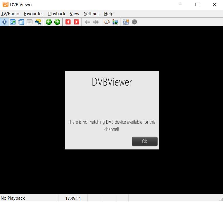

Im relatively new to DVBViewer though am able to set it up and access live tv ( UK Freeview) though after switching off my computer after an install the screen goes black. The signal strength appears to be 90% and the tv program information appears up to date though there is no picture. I have tried modifying the video renderer options in the direct X settings (in Video B) though this hasn't helped.

Hi i use a WinTv HVR 1200, ill take a look, thanks :)
I disabled the Windows 10 Fast boot though it doesnt seem to have made much difference. Could it be a problem with the driver not supporting Windows 10?

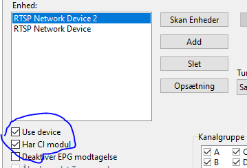

A long shot:
I know it is freetoair, but long time ago it worked for medvb.PNG.08d4bb50fb3f838488b857308dcd5ffe.PNG

I toggled the use device and restarted my PC and now it works (for now- well see how long it lasts xD).
Thanks for the help @MCenterFreak & Griga
