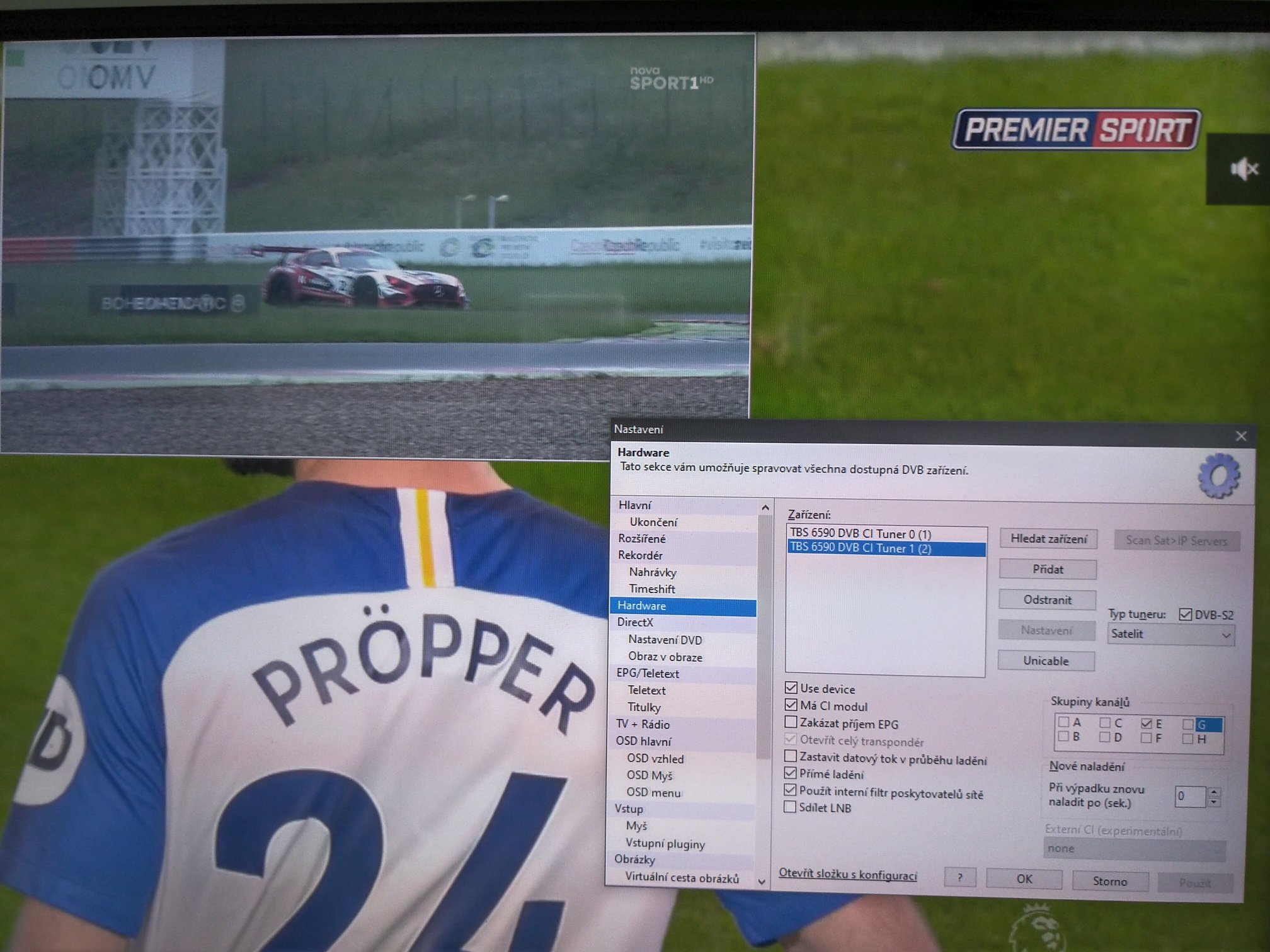

cyberreality Posted July 10, 2020 Author Posted July 10, 2020 PIP works well, see attached pic. main screen is telly while smaller one is skylink. and again, controlling card directly from DVBViewer i have problem to switch channel from one CAM to second one. no problem to do telly > FTA > skylink > FTA > telly or telly > turn it off > skylink ... seems like i'm going to buy DD Octopus CI S2 ... Quote
