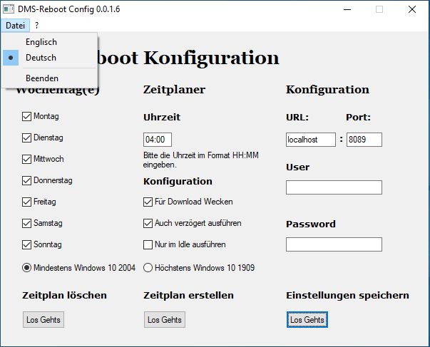

Hi.
Since there was a demand for a configuration tool, I just wrote one. The program is now offered as an installer package. After the completely normal installation, there is a new entry in the start menu that can be used to call up the config tool. Since it has to enter a task in the Windows task scheduler, it needs admin rights. If necessary, the corresponding data will be asked when the tool is started. Since Windows does not allow entries in the task planning by external programs without admin rights, this is unfortunately inevitable.
The actual configuration is almost self-explanatory. you select the days of the week (one, several or all) on which the computer should be restarted. You also set the time. This must be entered in the 24 hour format. You can also make a few other settings for the task. You can delete an existing task (if it has already been created with the config tool) and add a new task. Deleting is only necessary if you want to switch off the automatic reboot completely. Otherwise an existing old task will be overwritten when a new task is created.
On the right you can then enter the access data for the DMS. URL and port must be filled in. The preset values fit directly with a standard installation of the DMS. For User and Password you enter a possible username and the corresponding password. If no password has been assigned, the two fields must absolutely be empty, so they must not contain "0" or "no username" or something like that.
Since the version of the Task Scheduler XML has increased from 1.2 to 1.4 since Win 10 2004, you also have to specify which Windows version you are using. Otherwise the entry into the task library will not work. With 8.1 or 7, the 1.2 also fits. So here you select “At most Windows 10 1909”.
You can set the interface in English and German. A restart is then necessary to use the new language.
