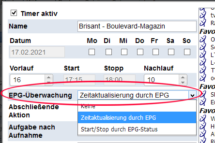

From your log: "Monitoring Mode: Start/end update by EPG" for this timer means that after an EPG update the timer is checked if the program times have changed and if yes (and the moved program can be found by ID) the start/stop times are changed. It does NOT mean that recording is controlled by live "... is running" / "... is not running" EPG status messages, those are only listed for information in your log.
See the difference in Griga's log above: "Monitoring Mode: Start/stop by running status", here the live running status messages from EPG are used for this timer. This option can only be set for a timer when DVBViewer knows that a channel sends this information. Only then the highlighted option in my screenshot (sorry, in german) is present, otherwise it is not shown.
vor 17 Stunden schrieb Cian:
It appears that even though I selected Running Status, it is insisting on using Start/Stop as the PDC monitor.
Your service.xml indicates "Start/Stop by EPG running status" as timer default setting. However, you also have to check the EPG Search page (if you are using it for timer creation), because it has its own independent set of timer settings.
Since Media Server 3.0.1.2 (which was a beta upload) "Start/Stop by EPG running status" automagically turning into "Start/End time update from EPG" is the expected behaviour, if the EPG data for the channel in question is not the usual DVB EPG, but originates from another source. However, there is no clear indication of an external EPG in your recording log .
Nevertheless it looks like the issue is caused by this change. But how and when does it happen? How do you create the timers? Did you already check the EPG monitoring setting in the timer dialog after the timer was created / before the recording was executed? See Timers page -> click the pencil (= edit timer) icon that appears on mouse over.
Up to now I can't find something in the DMS code that could explain this behaviour (provided only DVB EPG is assigned to the channels). Maybe your svcdebug.log (see configuration folder) can shed more light on it. Please attach it zipped.

vor 42 Minuten schrieb Cian:
when I click on a record icon (on the web EPG), the default that pops up is the Start/Stop. I change this to "Running Status" and click save, but when I look at the timer, is has reverted back.
Obviously triggered by external EPG data or by something that the DMS erroneously regards as external EPG data, as soon as the DMS retrieves the corresponding EPG entry.
