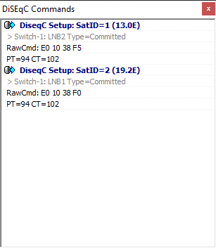

Radioman Posted July 19, 2021 Author Posted July 19, 2021 Finally! There was a new release of the driver from TBS with this comment "Fixed some bugs on diseqc function support". Sure, now it works OK with all three switches, that never worked previously. I.E he can switch from LNB1 to LNB2 and return. This is what it looks like with AltDVB: Is there a similar way to check the command with DVBViewer? Quote
Griga Posted July 20, 2021 Posted July 20, 2021 14 hours ago, Radioman said: Is there a similar way to check the command with DVBViewer? You can send command sequences by using DiSEqC = Extended and the DiSEqC Editor (more about it here - most of it also applies to DVBViewer) and afterwards inspect the raw commands in the file DiSEqC.xml (see configuration folder), that contains something like this: <?xml version="1.0" encoding="UTF-8"?> <settings> <section name="Commands2"> <entry name="0192">[E0 10 38 F0]</entry> </section> </settings> This is a Committed [Unchanged] raw command for Astra 19.2° East at position 1 (= A/A). Quote
