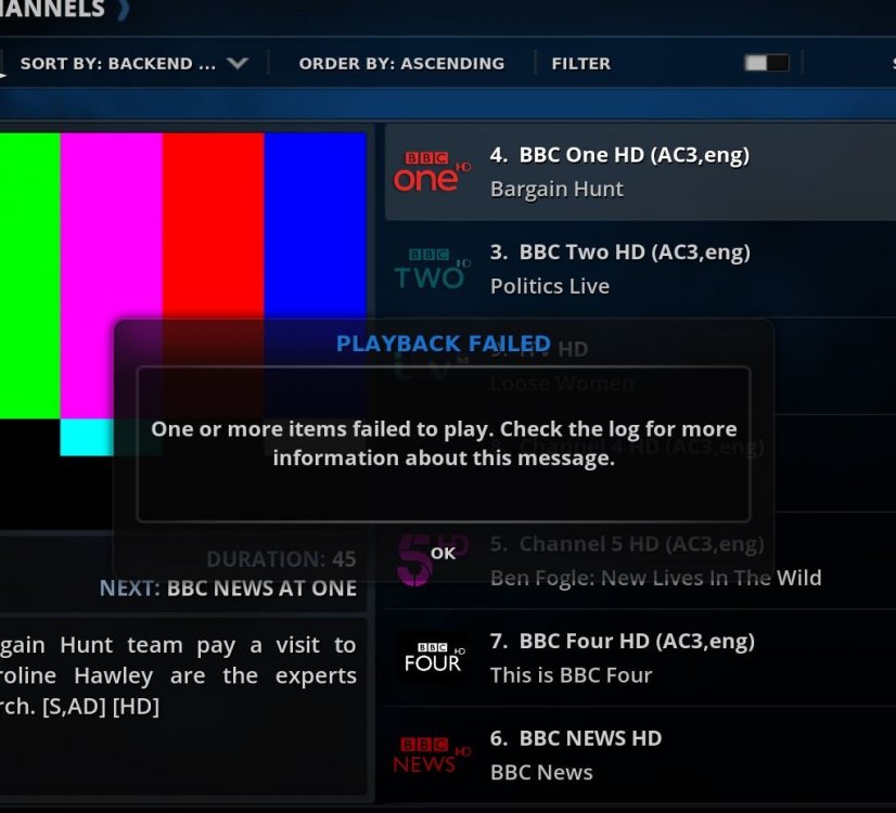

I cannot watch more than one satellite channel simultaneously using Kodi, but I can watch two channels at a time using two DVBViewer pro.
Either computer using Kodi will show me any channel, but when I try and watch on the second Kodi, I get this message (see picture)
Possibly because you have configured the PVR add-ons in both Kodi instances for transcoded streaming. Why did you do it? It's TS -> TS transcoding, as far as I can see, that only makes sense for lowering the data rate due to a limited network bandwidth.
Since transcoding requires quite a lot of CPU power, the DMS follows a "only one transcoded stream per client" policy: If client A receives a transcoded stream of channel A, and client B with the same IP address and user agent string wants a transcoded stream of channel B, the DMS regards them as a single client that performs channel switching, and closes stream A before delivering stream B.
This behaviour can be circumvented by giving each stream a unique stream ID in the URL Parameter input line of the the PVR configuration, e.g. streamid=1 in the first Kodi instance and streamid=2 in the second Kodi instance. Please read more about parameters for transcoded streaming in C:\Program Files (x86)\DVBViewer\docs\transcoding_params_en.txt.

PROBLEM Solved!
Thank you @Griga for your help, but in the end the solution was simple (as it usually is).
I came to Kodi from MediaPortal - this coloured my thinking.
In Mediaportal, the Timeshift folder is set by the TV server software and is COMMON to ALL Tuners and ALL Clients.
With this in mind, I made a Timeshift folder on the headless computer running the DMS software.
I then set each Kodi client to use this common folder - THIS WAS MY BIG MISTAKE!
When I made a separate Timeshift folder on each individual Client computer - the problem went away! - I can watch TV on many Kodi at at time now!
