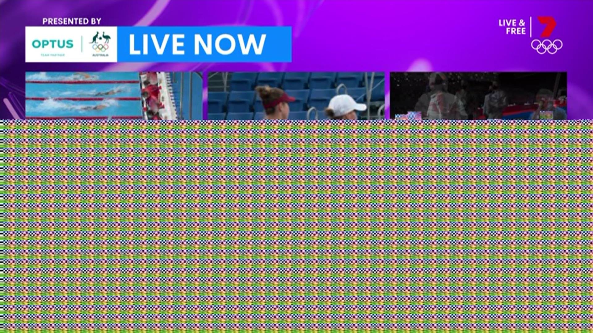

I use DVBViewer in Australia, and what I have observed with DBViewer 7.1.1.0 when:
 Options -> Playback Components -> Render/Decoder -> Video A -> MPEG-2 Video Decoder: Elecard MPEG-2 Video Decoder
Is that there are a lot of "Plaid Fabric (rectangular | square grids)" artifacts that tend to fill the lower half the screen, sometimes they go away layer by layer back to picture perfect, sometimes they persist, and it manifests on all SD (576p)  channels, and remanifests (if it has subsided), on changing to another channel.
This behaviour is not manifest on the HD (1080p) television channels, nor when switching between HD channels (it uses a different decoder, I also have Elecard AVC, in paid activated mode,  installed, and it is fine for the H.264 Decoder.
For what you've paid you additionally get some modern art. That's quite fair, isn't it? :)
The recommended decoders for DVBViewer are the FFmpeg based LAV Filters. They are free and provide excellent quality. So what I would do:
  • Check if the LAV video decoder for MPEG2 shows the same or a similar issue.
  • Check if the DVBViewer Filter property page reports discontinuities (missing data packets) in the incoming stream.
  • Check if hardware accelerated decoding (DXVA provided by the graphics card) is a relevant factor. It can be switched on/off on the property page of the LAV video decoder. See DVBViewer -> Settings -> Filters when the decoder is used. Select None or DXVA2 (native) in the "Hardware Decoder to use" dropdown list, click OK and perform Playback -> Rebuild Playback in DVBViewer to let the change take effect. Since I'm not familiar with recent versions of the Elecard decoder, I don't know if it ues DXVA and how it can be changed.

Thank you Griga.
0. Yes, a bonus "Easter Egg". :)
1. The LAV/MPEG-2 Video Decoder is fine.
2. Zero discontinuities.
3. There was hardware acceleration options for Elecard MPEG-2, cycles through -> Off -> Native -> Copy-Back, each with Playback rebuilds, and there wasn't any significant difference, as far as I could tell.
Most curious.
Thank you for your assistance.
I've lodged a ticket with Elecard technical support, to see what they make of it.
