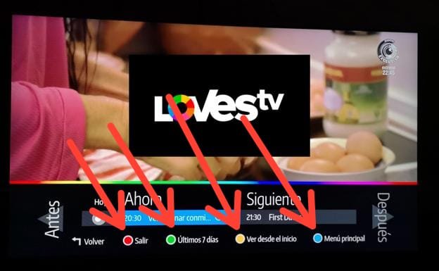

I recently bought the products "DVBViewer" and the "HbbTV plugin" to view this content. But I find that in Spain the blue button is used (very little the red button).
How do I access the blue button and the other colours from the HbbTV plugin? I attach screenshots so you can see how we use the buttons.
Blue: Public HbbTV, Main menu.
Red: HbbTV from private platforms (Not often used), Exit.
Green: View content from the last 7 days.
Yellow: View from the beginning (Rewind).
Thanks.

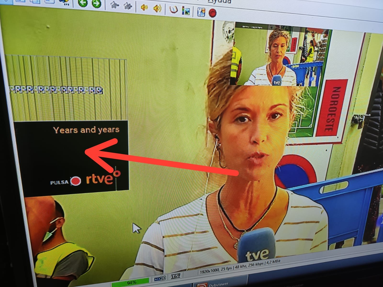

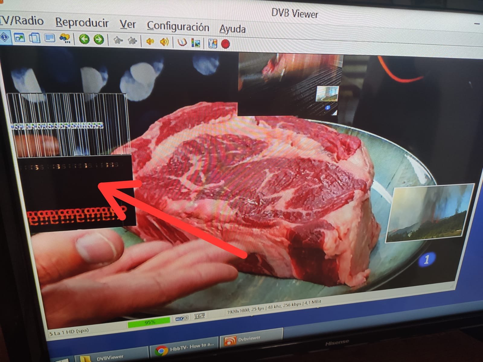

Unfortunately the above image only appears on TV, but not through the application. I have the plugin installed correctly, but it doesn't load HbbTV when I press the blue button and sometimes the application even closes automatically when I change channels and have the HbbTV plugin activated.
The HbbTV Menu only appears when I press the red button, but it appears in the wrong format and does not load correctly. As you can see, the blue button that should appear does not appear. Likewise, if I press the blue button, a menu appears in the middle of the screen (pause, recording...).
There is also a text in English "years and eyars", when there should be a text in Spanish (Comparing it with the TV).
