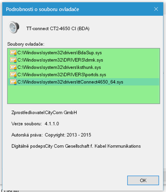

I don't have Windows 11, but the key driver (ttConnect4650_64.sys) of CT2-4650 CI is not signed by Microsoft. Can at all on the system with enabled secure boot working?
I have too this device but on Windows 10 (works without problems).

Under Windows 11 with secure boot enabled? I still can't believe it.
Honestly i don't know what secure boot is? , but It works again ?
Without enabled secure boot in BIOS is not possible to install Windows 11, at least as stated by Microsoft. And only drivers signed by Microsoft are allowed under Windows 11 (if I understand correctly).
