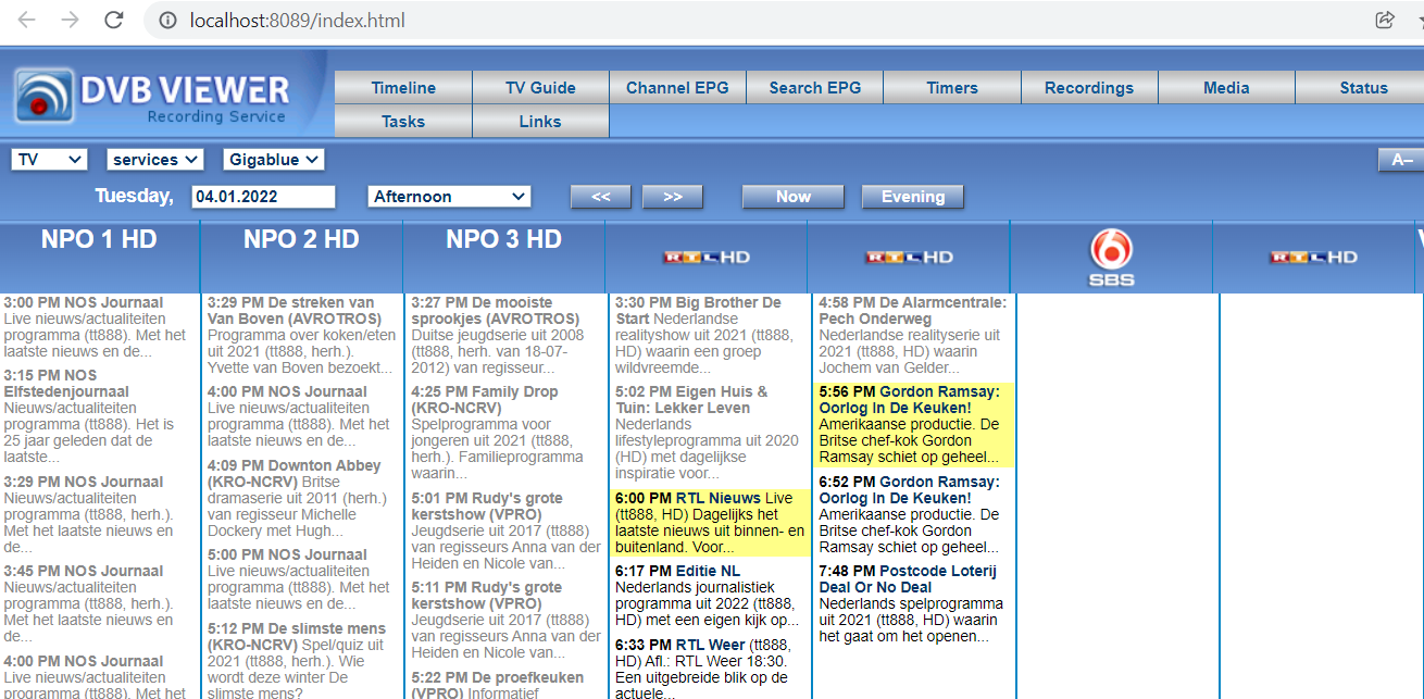

Attached is a sample, I watched all first 5 channels and only there EPG is seen.

update:
interesting enough in mws status it says 36.000 epg entries. When swiching to another channel the # of epg records does not increase but epg information for that channel becomes visible. It feels like all epg data is received, but only cannot be mapped to the channels unless you zap to that channel?
thanks,
Erik
Edited by eleijen
update 2:
once i select a channel for the first time, the pid information and video type is updated for that channel. Could it be that that is neccessary information for epg, so only thing i have to do is select all channels once so that channel information is updated and epg works? Will test and report back, but maybe you can give your thoughts about it as well ?
vor 14 Minuten schrieb eleijen:
Yes. Assigning EPG data to a channel requires that the Service ID, (Transport)Stream ID and Network ID of the channel is known. They constitute a kind of path to the channel. These values are not included in the M3U list (except the Service ID, that can optionally be specified by the #EXTVLCOPT:program=... tag) , so DVBViewer and the DMS have to determine the values on first tuning ("channel auto-update").
