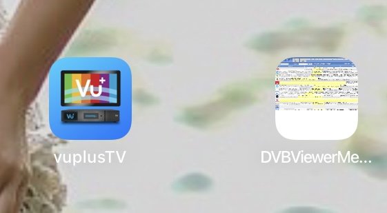

I noticed when going to DMS on my ipad and create a shortcut on my homescreen (Safari, Export, Add to Home Screen) I get a direct link to DMS but the icon is garbled, it is a mini representation of the webpage.

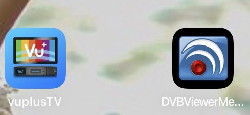

First things first, grabbed the 256 pixel DVBViewer icon from the gfx folder, renamed to apple-touch-icon.png -> black line around icon. Tried to resize png to 512*512, same effect. Converted a random jpg to 512x512 png, no black border. Reading along it seems to be wrong from the source and therefor creates a black border
i found a great site https://realfavicongenerator.net/ that gives the right preview of png files how they will look on apple.
maybe you can see if you can supply a png file that gives no black border.
will do the embedded code test later, although pretty sure it will work, as long as there is a png that does not give the black border.
some examples of how the icon looks like without the apple-touch-icon and the black border icon.
cheers Erik
Or Apple is to blame. Windows shows a transparent border. The PNG was created with Gimp, if I remember it correctly. I've loaded it with IrfanView and saved it with a transparent border, just to make sure, but the Favicon Generator site still displays it with a black border, commenting
Zitat
Your favicon is transparent. This is usually a good thing, but not for iOS Web Clips which are supposed to be opaque.
The upcoming 3.2.0 release will contain <link rel="apple-touch-icon".../> tags. If someone finds a solution that works under Windows and iOS, it will be used in future. Otherwise iOS users will have to live with the black border. I'm sure it won't kill them. To be true, I'm a bit tired of having to provide a special solution every time when it comes to Apple ;)

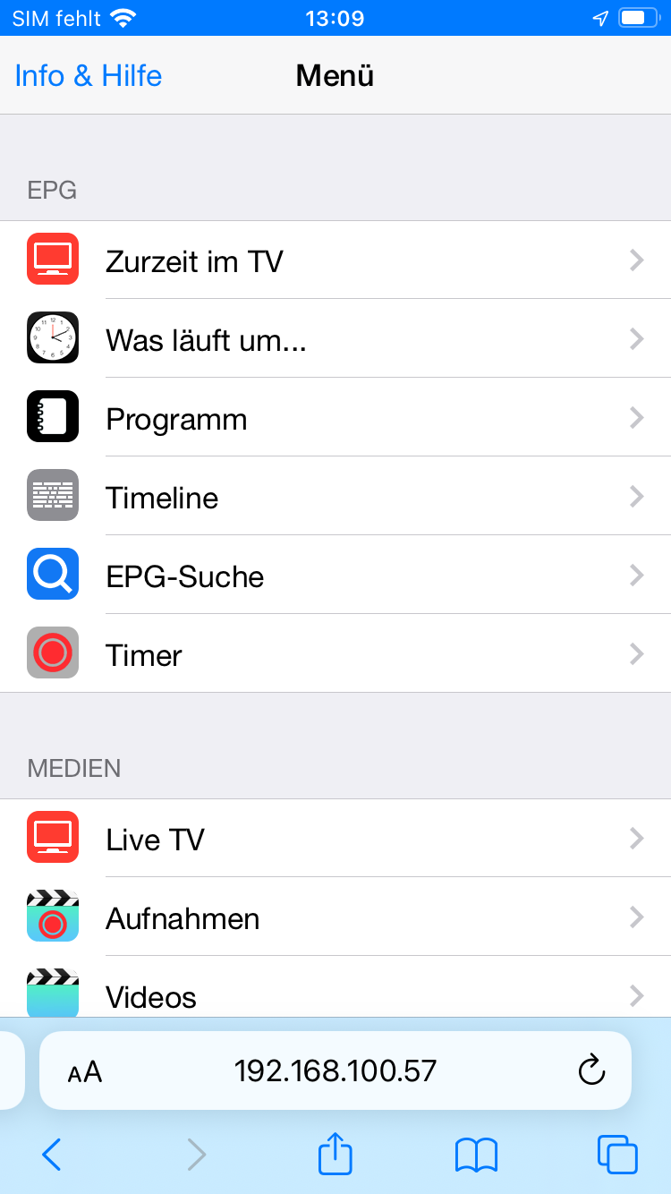

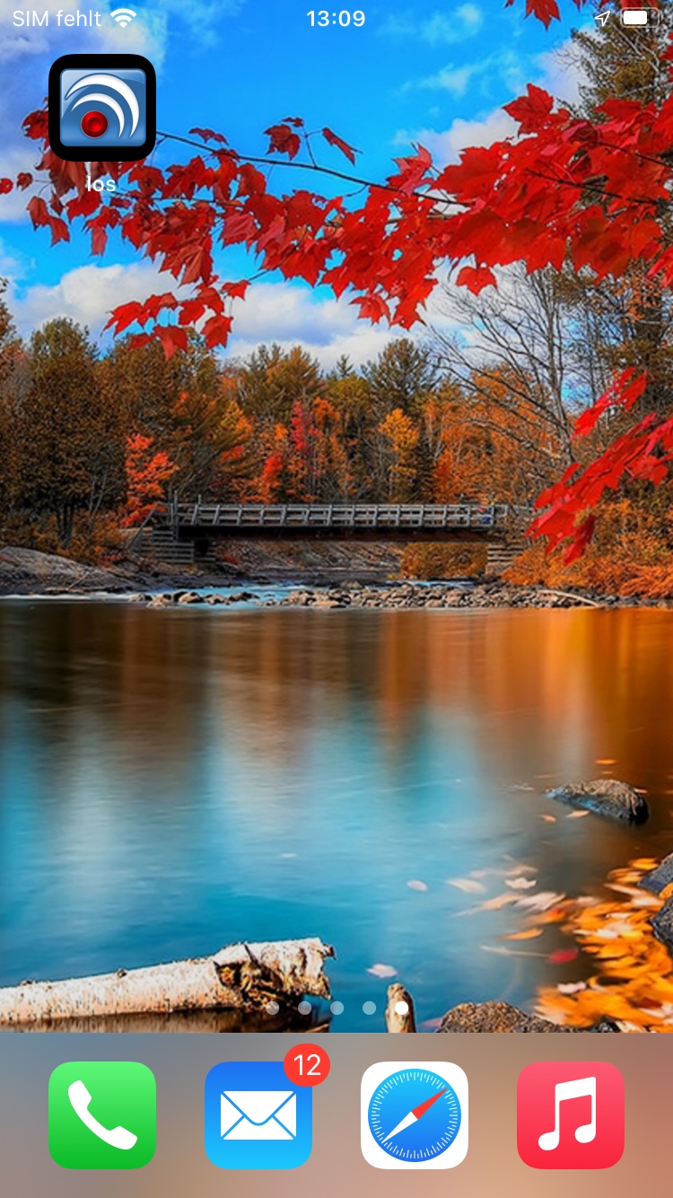

I tested this here on my phone and it works like it should. The icon is shown in the browser and when I add it to the Home Screen it is also available.
I also tested if a password can be used within the url, in my case http://admin:admin@192.168.100.57:8080/ios/  (//admin:admin@192.168.100.57:8080/iOS/)
 and it worked like it should. No given password would force the browser to ask for the credentials while connecting.
