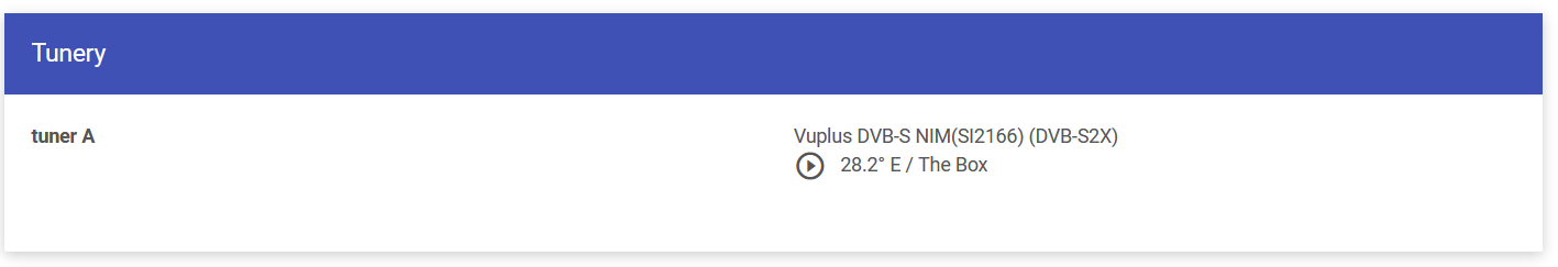

cyberreality Posted April 8, 2022 Author Posted April 8, 2022 got it and configured it. BUT on web mgmt in about section shows this that means that channel is tuned on tuner so i cannot switch channels via m3u plalist, all i can tune is this particular channel ... so is there any way how to stop playing sat channels on VU device and just use m3u playlist? btw once i stop watching channel will it release on VU device? so it will wait for another command? nothing tuned meanwhile? Quote
cyberreality Posted April 8, 2022 Author Posted April 8, 2022 found it i had to switch to old web design and turn off channel plaing, now works flawlessly btw how EPG update works? yes its clear it will tune channel for a while so there will be some traffic, i dont care. but if i'll watch something from VU, will it break it or will it wait till nothing is tuner from this device? thanks! Quote

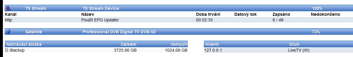

cyberreality Posted April 10, 2022 Author Posted April 10, 2022 okay, i've disabled epgrefresh on VU and started manual epg refresh in DMS so as you can see it does something, 8 of 49 is done and this is what i can see on VU's web mgmt plus i can see network traffic on mikrotik. so DMS fetches whole channel data, it was about 12mbps for this particular channel. Quote

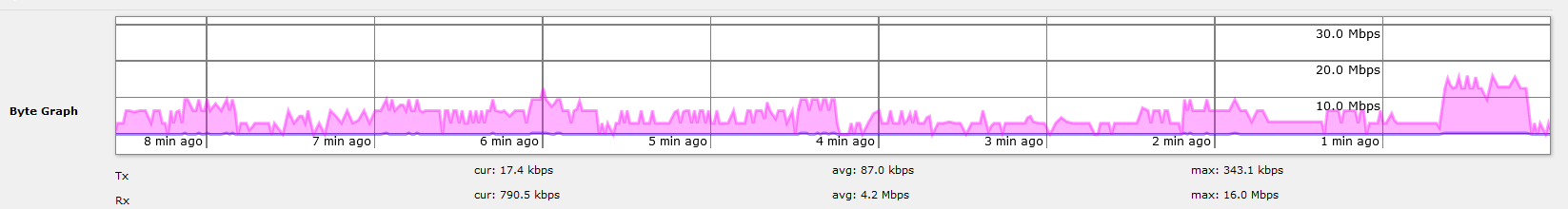

cyberreality Posted April 10, 2022 Author Posted April 10, 2022 (edited) epg update cycle on VU's port on mikrotik. different bitrates for different channels. btw about 30s per channel while 120s is set? Edited April 10, 2022 by cyberreality Quote

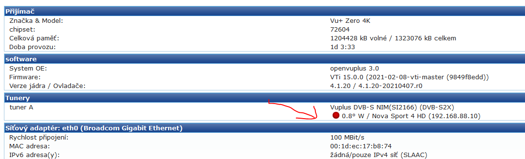

cyberreality Posted April 10, 2022 Author Posted April 10, 2022 On 4/9/2022 at 10:11 AM, Griga said: The Background EPG Update in the DMS well, is it possible to force EPG update to stay at channel for certain amount of time? now i have set 240s per transponder but while doing epg update from VU it stay about 10s on one channel. soon i need to reboot VU because CAM is frozen and no channel works, even i connect VU to monitor and check "locally" on it, nothing works unless restart. Quote
