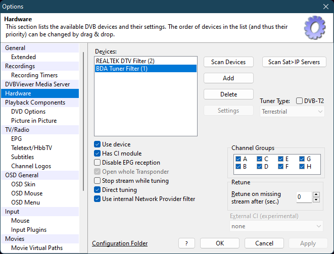

I have a MyGica S270 and I acquired a DVB-T+DAB+FM+SDR based on the REALTEK 2832U Device chip because it has the FM radio function, but the DVBViewer did not detect any FM Radio, I installed the program that came on the device's CD the BlazeHDTV 6.0 program that didn't work right away I had to look for a configuration on the internet to make the program work and I managed to make the program work even though I wanted to detect some TV channels and FM Radios but I really wanted to use DVBViewer to tune in to the FM radios.
Yet another question when I detect the two devices the DVBViewer stops tuning the TV channels, to return the TV channels I have to delete the REALTEK device, how do I keep the two devices without harming the TV channels tuning and still tune the FM radios?

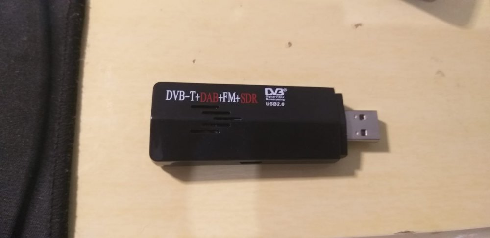

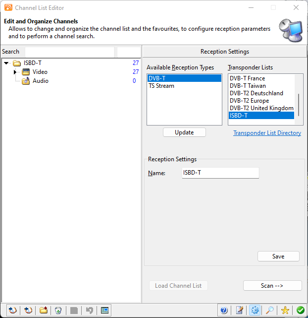

This is the photo of the DVB-T+DAB+FM+SDR based on the REALTEK 2832U Chip I still can't tune into TV channels on it but to my disappointment I discovered that this Dongle is (1-Seg) the maximum that the chipset supports, where the resolution varies from 240x180 pixels, 320x240 pixels or 320x180 pixels, even then I would like to configure channels on it.

on your picture I can see "DVB-T+DAB ...".
Which TV-system is used in your region? DVB-T or the 'new' DVB-T2 HD? It seems that your stick only supports DVB-T. DVB-T2 is a new HD-TV with a greater resolution. This can't be received by a simple DVB-T Stick.
For radio reception (FM + DAB) your stick your stick should be usable with the software that came with the stick. If it is realy only a DVB-T stick you should get a DVB-T2 HD stick like the astrometas (for example look for "TOOGOO USB 2.0 Digital DVB-T / T2" at amazon).
Many greetings
Webturtle
Here in Brazil it is ISDB-T (SBTVD) and DVB needs to be adapted to work here, as can be read the instructions for the program that came with BlazeVideo HDTV Player 6.0 to work on this page that is in English, use Google Translate to translate to English, I put this BlazeVideo program to work, but what I want is for DVBViewer to work.
In BlazeVideo it only tunes channels 1Seg because this device is not HD Video.
https://www.hardware.com.br/comunidade/blazevideo-hdtv/1457679/
Page in Portuguese to make the BlazeVideo 6 program that comes with the device work here in Brazil, use the Goggle Translator to translate it into English.
No idea how to configure the device here to work with DVBViewer here in Brazil?
