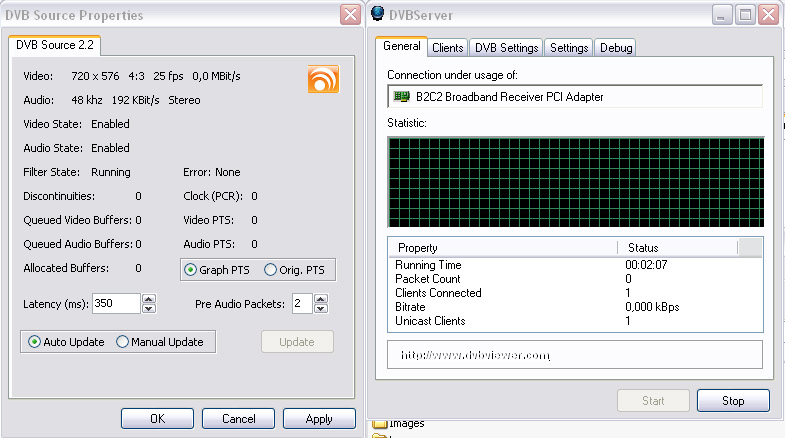

DVBViewer 3.0 is really nice, but I cannot make the DVBServer and/or Client to work. I have checked the http://www.DVBViewer.com/oliver/Optionen.html#network -documentation, but it didn't help... I have tried it within localhost and over LAN to another computer without success. I can always get connected either with unicast or multicast settings but there is no bitrate!
The same thing was with DVBViewer 2.3 beta and DVBServer. However i could see some bitrate with the graph in v2.3 DVBServer but still no picture or sound in DVBViewer.
I can see in the DVBServer debug tab that channels and PID:s are tuned but thats all!? Firewall is not the issue because it's open...

I've attached a screenshot of the DVBServer and DVBFilter if its any help?

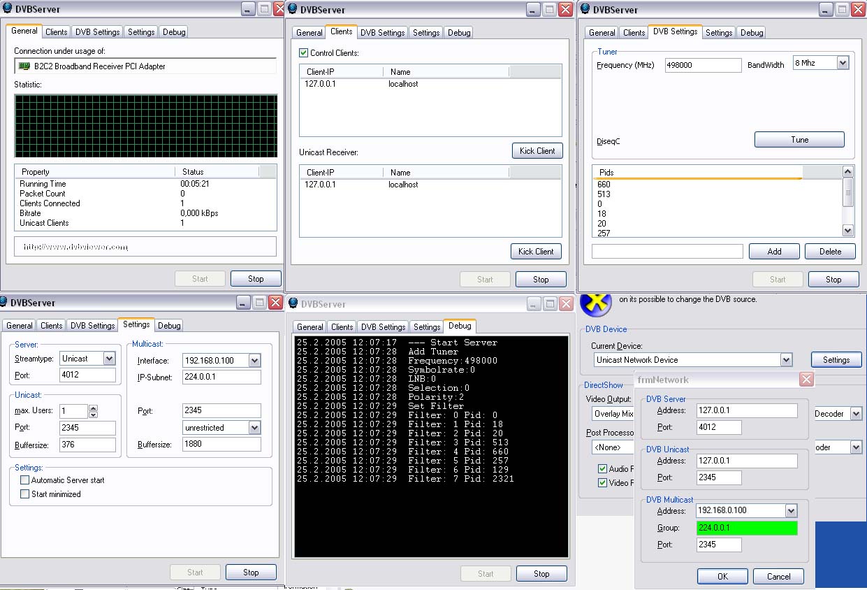

The same screenshots I have posted in the manual would be more helpful. Additionally or alternatively you could post the server.xml and the hardware.xml (both located in the DVBViewer folder).
Bye, Oliver
Here is the screenshot of all tabs in DVBServer and my unicast settings in DVBViewer. I also included the .xml files.
I also found that the unicast max. users -setting doesn't seem get saved/loaded properly because each time I restart the DVBServer it has setting "1".
My default NIC has static IP 192.168.0.100 received from DLink router via DHCP...

hardware.xml
server.xml
