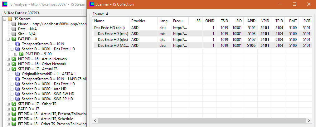

Here it works with a stream created by the DVBViewer Media Server:
I would need the complete URL of your stream for additional tests.
Does the wrong ONID 56696 appear somewhere in the SI tree? Please use the Analyzer "Find" function for a check.
