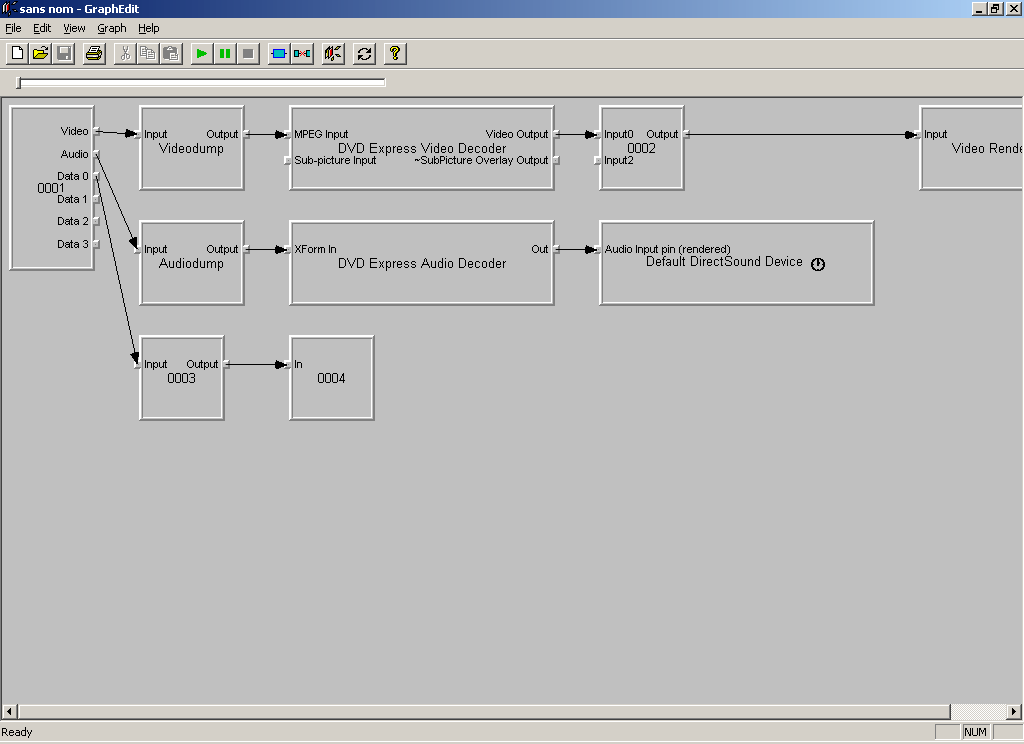

Sometimes, randomly, it displays a few images evrey seconds, and there is sound output randomly, in this case the GraphEdit gives the following "dvb random.bmp":

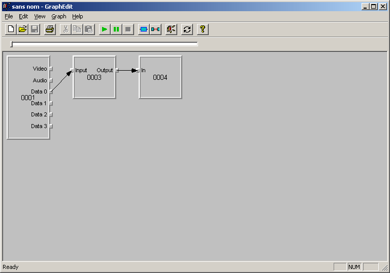

But most of the time, when it is not working , the graph is the following:
Question : Could you please let me know how to make it work correctly ?

Well, after lots of tries, I figured out that the SONIC DVD codec is just not installing/running properly in my system, so I trashed it and when I keep my PowerDVD setup it just runs fine (and much smoothly, no blocking effect).
I'm afraid Technisat and you guys may just run into lots of these stupid questions related to codec error.
