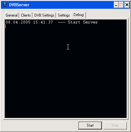

What now happened is that
08.04.2005 15:03:24 --- Start Server
appeared in the debug window,
but the active button switched back
to start again.

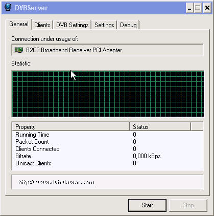

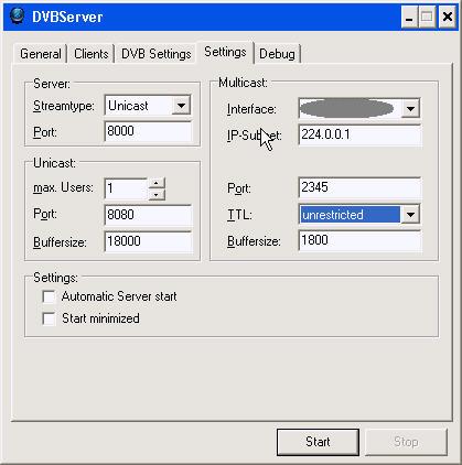

Anyway, i've attached some screenshots how it looks to me.
It even looks like this when I have clicked start.
I haven't included the other two sections as there are obviously
no clients listed and I do not understand the DVB Settings tab.
I tried to tune (with a frequency I looked up from a transponder
of a program I'd like to use), but nothing happens.
Do I have to have a transponder tuned to be able to start the server?

I found out why it did not start.
For unknown reasons, port 8000 was already used,
and there is no error displayed in that case.
I think an error message should be added.
