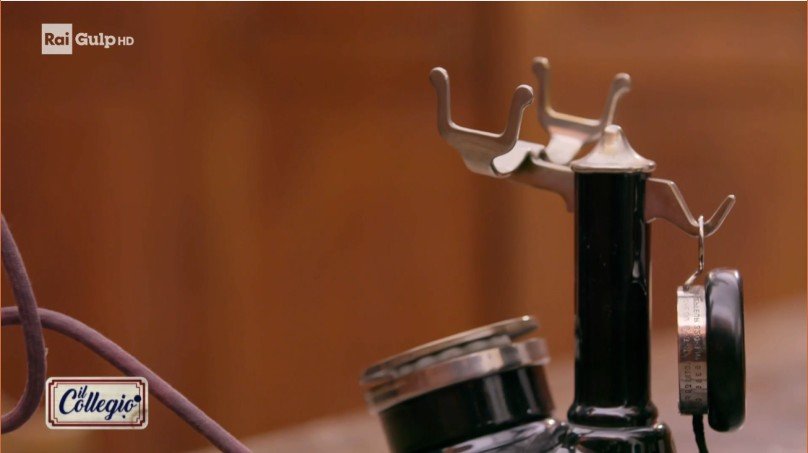

At the moment I can not attach any picture since they are 1.9 megs. But I can say that at the beginning, after selecting the channel, the picture starts ok, but after a while (less than 1 second) the black border is appairing and the pictures lost the external part.

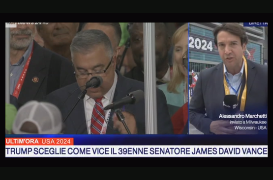

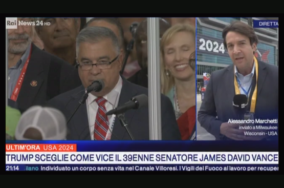

as soon as the channel is selected you can see as OK but after a while (less than 1 sec) the picture becomes as KO

Which picture is ok for you? The first one or the second one? Or none of them?
Both look cropped, the first one more, the second one less. Parts of the borders are cut off. Here is a screenshot of an unencrypted RAI channel that I can receive from Hotbird. Have a look a the channel logo in the upper left corner and the space around it. That's how it should look like. Did you check the DVBViewer zoom settings?
Yes you are right, the second one is better, it would be enough to me, but after a little while it becomes as the first.

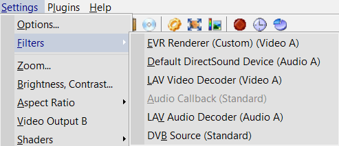

Please check in the Settings -> Filters sub-menu if the playback components used by DVBViewer are the expected ones. Usually it should look like this:
