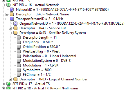

Thanks, however on my case - TransEdit shows me for a DVB-T2 stream, information about satellite delivery system - which is all fabricated.
I assume it could be that the broadcasting network does not broadcast correct metadata - but still, wouldn't transedit is able to tell which modulation, guard interval etc. the stream has?
On my end, the descriptor says "Satellite Delivery System" and all the information is satellite based

vor 22 Stunden schrieb Eyal:
This violates the DVB specifications. Probably the terrestrial broadcasts are using a stream originating from a satellite feed, without converting the SI tables accordingly.
