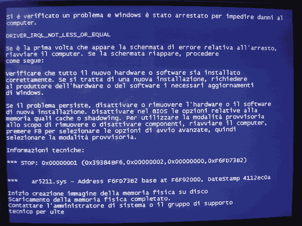

Attached a screenshot of a Blue Screen of Death related to use of Skystar2 and a Atheros wireless on A8N-SLI

Hmm - in the case of your bluescreen the driver for the wireless card is the cause of the bluescreen - don't blame the SkyStar 2!!!
The nForce 4 chipset seems to be faulty at all - and it is not always the Skystar 2, which causes the trouble. Also some TechnoTrend cards (i.e. Haupauge Nexus) are not working properly with those mainboards.
Sorry my friend. Skystar + Wireless = Crash, Skystar alone without wireless card = Jumping Audio / Disturbed video + Overall system instability.
As other have said it is due to Asus and their reckless marketing of this defective board.
Chinging board now, will keep all updated
Enrico
Well, but the bluescreen tells you, that the driver for the wireless was the cause for this specific crash... :D
The nForce 4 MoBos have problems with many DVB-S cards... like the Haupauge Nexus-S/TT Premium S...
