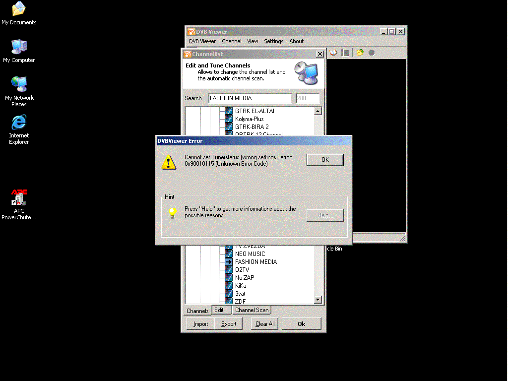

cannot set tuner status
certhas
Cannot set tuner status (wrong settings)
error 0x90010115 (unknown error code)
I get this error when i try to switch the channels. (im using skystar2)
Is there anything else beside the normal installation i have to do to get DVBViewer to work ?
Can anyone help me ?

I have the same problem
i'v got the new SkyStar 2 rev2.6.d card
there was CD with version 4.23 drivers
DVBViewer and MS Mediaplayer 9 inside the pack
first time I'v decided to do not instal it and tryed the 4.22 version drivers that i'v dowloaded somewere with TV4PC inside
the signal quality was yelow 25-30 and on some transponders even red 8-10
TV4PC worked w/o any problems , any programs showed w/o lost frames etc even those that are on red signal quality transponders
then I'v tryed to install that 4.23 drivers from the CD
this pack automatically installs MS Mediaplyer 9 DVBViewer(intergrated winlirk) and tuner setup Setup4PC
I'v setup the tuner
the signal quality on the same SAT on the same transponders was stable yellow and some are was green
so I'v runned the DVBViewer and got the subjected error message
I'v tryed to find what is wrong but nothing found decided to uninstal this 4.23 pack
and installed again 4.22
after that TV4PC was rejected to work too !
so I'v reimaged the PC and installed back the 4.22 pack and TV4PC is working by now.
so what may be the reason of this that TV4PC is working fine with low signal but DVB viwer is not? ofcourse if this low signal is the reason of problem.

after my post I'v installed all back (4.23) and runned the LogMPEGDecoder.exe
and this error message some time is not apperaring and i can see some programs on the signal 18 and 25
but it is unstable if i'm changing the chanel it may appear again
and disappear after restart
in any case there was no any problems with TV4PC but I'd like to use
DVBViewer :-)
