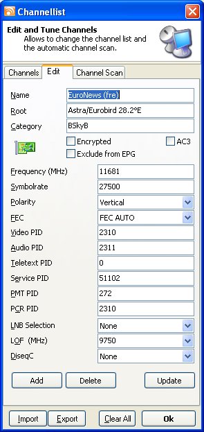

I have attached 2 examples, the first Extreme Sports Channel works OK, and the second Euronews has the sound problem. Maybe this will help somebody spot a problem.
Obviously I did not try the right Audio Decoder in DirectX. I am now using a decoder that came with a TV tuner card I used to have installed. All is now OK (I hope).
Thank to Lars_MQ for pinting me in the right direction. I am not sure I understand why some stations worked and some did not, probably some technical sound transmission reason.

Some audiodecoder have problems switching between stereo and mono, or have problems with mono at all. This causes the mickey mouse effekt. ;)
