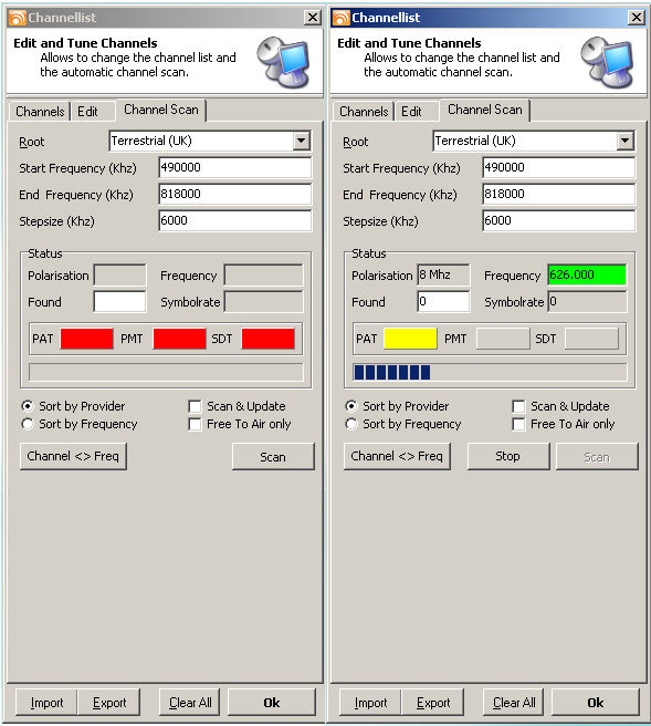

Now that the latest version of DVBViewer supports BDA I am trying to get my Twinhan Alpha USB 2.0 device working.
The Alpha is recognised by the program but when it comes to doing a Terrestrial scan for channels no channels are detected. My tuner is responding whilst tuning but even though I have inputted the start/end frequencies i want scanned and the Polarisation is set correctly at 8Mhz nothing is found.
What is puzzling me is that whilst scanning the program appears to be locked to the PMT setting and I think it should be on SDT setting.
Is there anyway to make it scan using the SDT setting?

Each time I go to Channel List/Channel Scan and try scanning for UK Freeview channels none are found. Whilst the scan is in progress the light on my tuner goes on and off as various frequencies are being scanned, so the program is communicating with the tuner.
Here is how the Channel Scan is setup:-
The BDA driver that I am using is working with three other TV software programs without problems.

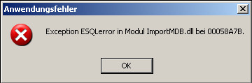

I have tried importing my channel listings from 'MyTheatre' program using the import button in the Channel window but it returns an error:-
