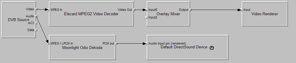

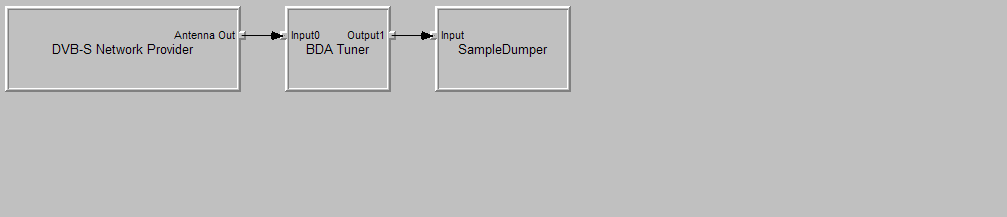

Griga Posted October 23, 2005 Posted October 23, 2005 Strange - after registering tuningspaces.reg I got two DVB-T tuning spaces and one DVB-C - even with that one it worked - but no DVB-S. How did you manage to scan the DVB-T channels? If the channels are not tuned correctly, scanning doesn't work either, I suppose. Do you know GraphEdit? Would be interesting to have a look at the BDA DirectShow filters that DVBViewer Pro uses. Quote

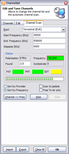

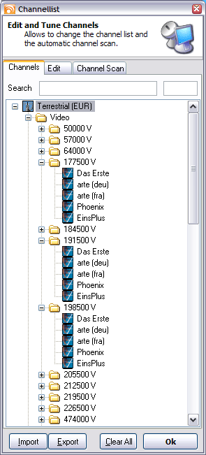

maxx2097 Posted October 23, 2005 Posted October 23, 2005 Hi... ...scanning works works and completes quite normal I think... but it only finds the channels of the frequency I last tuned to with another software. E.g. if I watch ARD with the Cinergy-App, close it and open DVBViewer I can find all the channels from this bouquet (ard, arte, and so on). But these channels are found for all frequencies that are scanned (see screenshots). I dont realy know how to use GraphEdit, but I downloaded it and connected to the running filters of DVBViewer. I also made some screenshots of the 2 running filters. cheers maxx Quote
Griga Posted October 23, 2005 Posted October 23, 2005 There is a DVB-S Network Provider in the graph, which is definitely not correct. Should be a DVB-T Provider. Are you sure that the scanned channels are listed as DVB-T in your channel list? How does the Edit Tab of those channels look like? When DVBViewer Pro builds the graph, it inserts the appropriate Provider according to a TunerType parameter. Obviously the wrong one in your case. The TunerType is derived from a list of BDA hardware devices that is created on startup, by inserting all available Network Providers and Tuner Filters into a temporary graph and trying to connect them. If a connection succeeds, the Tuner Filter is registered as device, and the TunerType is determined by checking to which Provider it connects. Usually a DVB-S Provider won't connect to a DVB-T Tuner - at least I can't do it manually in GraphEdit. Check it. Launch GraphEdit, go to Graph -> Insert Filters, pick a Network Provider and the Cinergy Receiver Component out of the list and try to connect the pins manually (by dragging the mouse from pin to pin). Play a bit with it. After having connected the Provider and Tuner, you may render the Tuner's output pin (right-click it) to let DirectShow build a complete BDA graph. After that, you can open the property page of the Provider (right-click it) and enter a tune request (mainly the frequency is required for DVB-T, and the SID if you want a specific channel). Click submit and finally GraphEdit's play button. That's how I managed to play TV in GraphEdit. Maybe in this way you can find out what causes the trouble. Furthermore, how does the content of your Hardware.xml file look like? First check the file UserMode.ini in the DVBViewer directory, and examine the Hardware.xml (e.g. by opening it with NotePad) in the directory according to the UserMode value: 0: in the DVBViewer directory 1: in Documents and Settings\Username\Appdata\DVBViewer Pro 2: in Documents and Settings\AllUsers\Appdata\DVBViewer Pro Post the content here. My hardware.xml contains: <section name="Cinergy T2 Tuner/Demodulator"> <entry name="TuningSpace">true</entry> <entry name="TunerType">2</entry> <entry name="TuningName">ASDVRDVBTTSCSCS2</entry> </section> TunerType 2 is DVB-T, 1 is DVB-S. Quote
