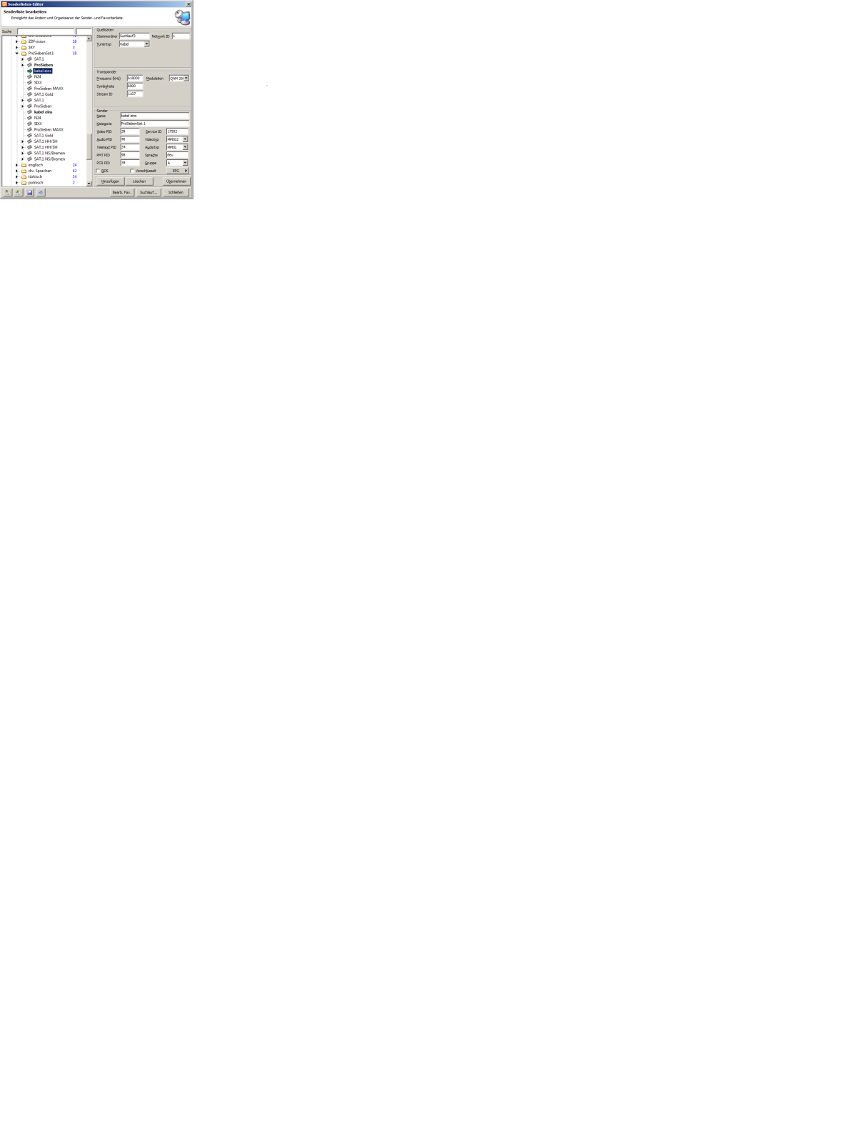

My "Senderliste" in DVBViewer looks as in the picture attached below (strangely, my "Suchlauf" found some duplicate entries in the "ProSiebenSat1" group (I also have duplicate entries in some other groups, but as far as I can see, the entries are exactly equal, is this harmful?).

The Recording Service only loads a new / changed channel list (channels.dat) after being stopped and re-started. Maybe that's the reason.
So the problem are the dynamically changing video and audio PIDs, is that right ?
How does DVBViewer detect this changes ?
From mails you and Derrick wrote in similiar threads, I guess this changes are published in
the PMT or EPG stream ?
Why can't RS do something similiar ?
Looks like initially the RS used wrong channel resp. PID data. After stopping and restarting the RS (by system shutdown / reboot) it loaded a channel list with correct data.
Dynamic PID changes on Kabel1 and RTL would be very unusual, but who knows? Might be as well a configuration fault.
If you want the RS to respond to PID changes, tick "Auto split on channel data change" in the RS Recorder options. It lets the RS stop and immediately restart a recording if monitoring the PAT and PMT reveals that that the recorder is using wrong PIDs.
However, the RS doesn't write to the channel list. Only DVBViewer does (and maybe TransEdit, if you are using it as scanner). So the RS won't correct wrong PIDs permantly. DVBViewer does if you switch over to a channel and Channel -> Auto-Update Channel is switched on. I guess using DVBViewer corrected the wrong data, and the RS got it next day...
It's better to have a channel list without ambiguities. Even if they don't cause obvious problems now they are a potential source of trouble. DVBViewer doesn't take care of consistency, so you will have to. Maybe it already caused the problems described above.
