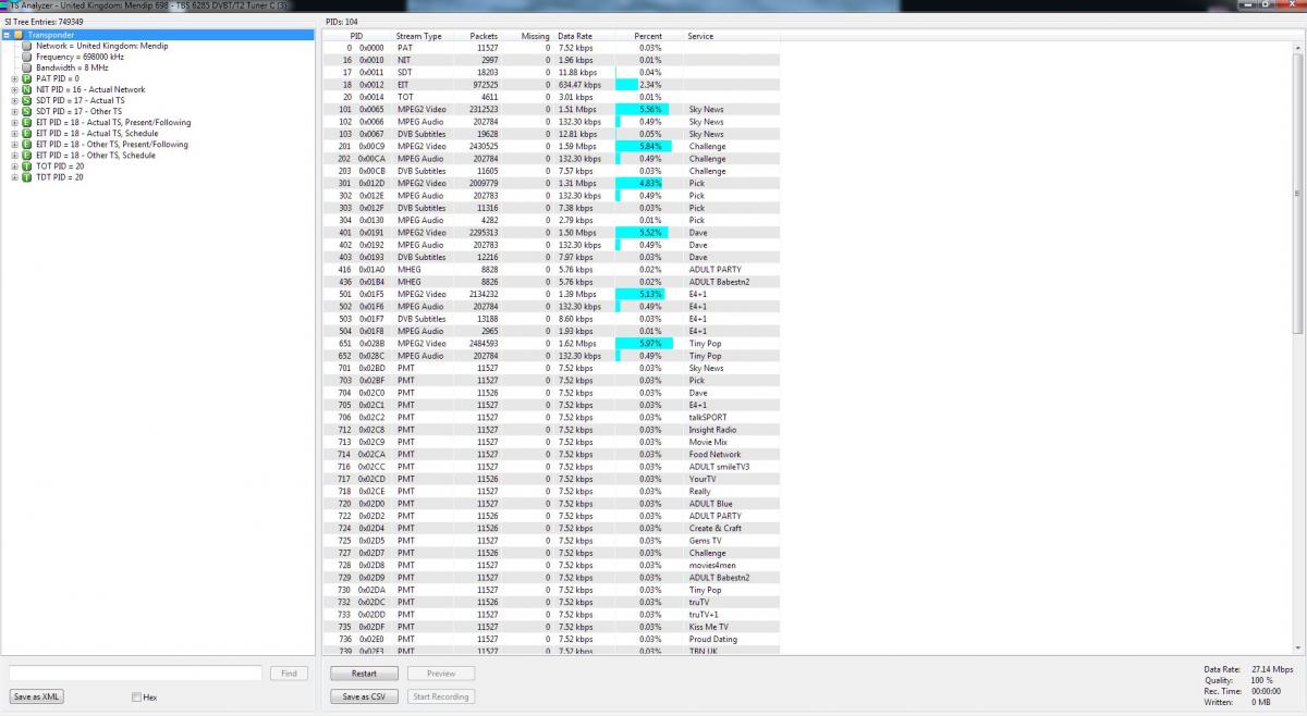

fozzy Posted March 3, 2016 Author Posted March 3, 2016 It would seem that DVBViewer is not tuning or storing a certain rage/frequency which contains Motors TV it is available on freeview UK as I have it on my TV. After discussion on another forum regarding freeview in general in the UK as I was having a similar problem on my TV which has now been resolved on my TV however the channels on coms 4 and coms7 IPTV as shown below are still not working on DVBViewer. https://ukfree.tv/prediction/PGSTART1840/#pagebar fozzy: In that case it would appear that for some reason or another your TV is failing to store most of COM4's IPTV channels, as 239 is broadcast on COM6 and with 256 being on COM7, the odd thing about this being that 248 (Africa Free TV) "is" on COM4.As all these missing channel numbers are definitely broadcast by Winter Hill, albeit that its a bit of a bind having to do this, but you should try carrying out a "factory reset" on your TV and see if this resolves the problem, the procedure for same listed on page 196 of your i-manual.I have tried everything to resolve this please HELP. Quote

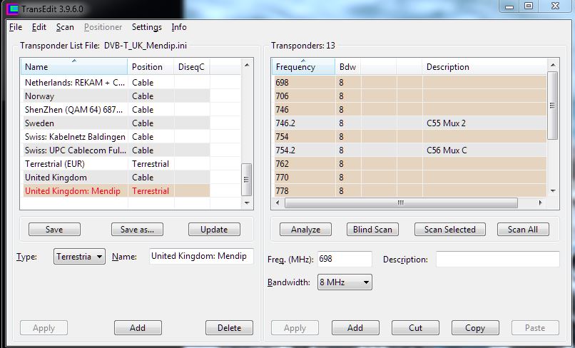

Tjod Posted March 3, 2016 Posted March 3, 2016 Download TransEdit 4.x from the Members Section. And put the TransEdit.exe in the DVBViewer program folder Then start TransEdit select the transponder and then click on Analyzer. Which channels are listed there. Quote
fozzy Posted March 3, 2016 Author Posted March 3, 2016 (edited) Hello and thank you. I see the following, i tried to save the info but could not select or see where it was saved to so find attached screen shots. From what I can see all the channels that I spoke of are missing. Edited March 3, 2016 by fozzy Quote
fozzy Posted March 3, 2016 Author Posted March 3, 2016 Hello and thank you. I see the following, i tried to save the info but could not select or see where it was saved to so find attacked screen shots. From what I can see all the channels that I spoke of are missing. Quote
fozzy Posted March 4, 2016 Author Posted March 4, 2016 Ive now loaded the new channels using Transedit thank you kindly for pointing it out, the channels where absent as my local transmitter is not "mendip" which is the only preinstalled UK service so it was missing an entire mux stream out making up another 10 channels or so. However it would seem DVBViewer doesn't support them as they are all streaming which is very disappointing as I would of thought it would keep up to date with current TV services being PC based. So I am stuck with viewing through my standard TV unless anybody can update the software? Quote

Tjod Posted March 4, 2016 Posted March 4, 2016 The upload space in the forum is limited but you can delete old not needed contend. http://www.DVBViewer.tv/forum/index.php?app=core&module=usercp&tab=core&area=attachments (only the Analyzer screen shots are interesting for the problem) So the channels have a PMT entry but no video or audio. Therefore the channel scan will categorise them as inactive. If you have them in the DVBViewer channel list, and the HbbTV/MHEG 5 addon installed. Try if MHEG 5 is working go on a channel with MHEG 5 and press OSD-red [F5] do you get the MHEG 5 overlay/interface? And then try one of the "inactive" channels and press OSD-red. Quote
