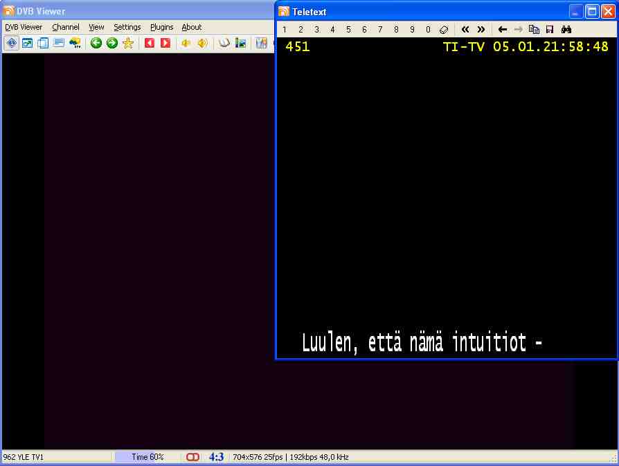

emmel Posted January 4, 2006 Posted January 4, 2006 (edited) Sorry about this continuous everlasting whining about subs... The problem is, that the teletext-subs of DVBViewerPro 3.2.6.80 have not worked with all Finnish channels after 3.1.2006 (probably due to some changes in teletext-stream). Recording of the teletext subs in ts-format is ok, and we can eventually verify their existence by demuxing the recorded ts-file. You can also watch the subs in "DVBViewer->Teletext", but watching them with "View->Show subtitles" does not work at the moment. Hard to say how the stream has changed exactly (or maybe it has not), I'm not an expert here. But they seem to send the subtitle page header line (packet number zero) in an completely different manner and order than before. Edited January 4, 2006 by emmel Quote

emmel Posted January 5, 2006 Posted January 5, 2006 Hello, I just did some modest checking, and found out that in the "new" problematic teletext-stream of yle there is the following difference with respect to the "old" stream: New stream (not working with dvbv currently): Teletext page header (ETSI EN 300 706 v.1.2.1, section 9.3.1) has sub-page code S1=5 and S2=S2=S3=0. Old stream (works well with dvbv): S1=S2=S3=S4=0. To be more specific, byte 6 of the subtitle page header has changed from value 0xa8 to 0xce. Difficult to find any other differences in the streams. I also checked the page headers of another pay-tv channel that uses txt-subs, and noticed that also they have S1=S2=S3=S4=0. Their txt-subs work fine with DVBViewer. Do you think that this change in the header data could explain our missing txt-subs? BR Quote

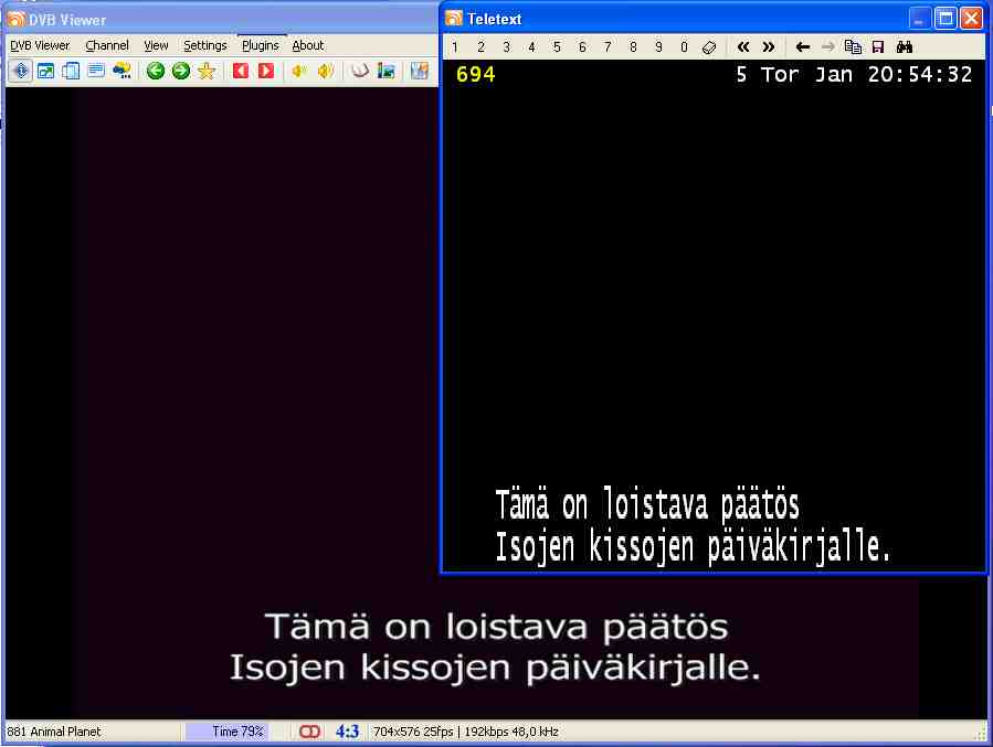

emmel Posted January 5, 2006 Posted January 5, 2006 (edited) The teletext module of DVBViewerPro (DVBViewer->Teletext...) in fact shows the subs correctly. It is the osd selection View->Show subtitles that does not work. Both s and t the same thing. Check Discovery (1W, 11229H, 24500) for example. Page 694. The subs are unencrypted and shown correctly in both ways - with the txt-module as well as on the screen. Then rechech the channel you already did (or some of the yle channels - probably some of them is sending subs): no subs on the screen while the txt-module works. Confusing... [edit] Two samples: non-working and working, both from 1W. Edited January 5, 2006 by emmel Quote

Derrick Posted January 5, 2006 Posted January 5, 2006 The teletext module of DVBViewerPro (DVBViewer->Teletext...) in fact shows the subs correctly. It is the osd selection View->Show subtitles that does not work. Both s and t the same thing. Check Discovery (1W, 11229H, 24500) for example. Page 694. The subs are unencrypted and shown correctly in both ways - with the txt-module as well as on the screen. Then rechech the channel you already did (or some of the yle channels - probably some of them is sending subs): no subs on the screen while the txt-module works. Confusing... [edit] Two samples: non-working and working, both from 1W. This thread is a mess @emmel, you are only referring to ttx subtiles, are you? On 11229H there are no dvb_subtitles. Discovery is a special case.. ..this one is working correctly with ttx_subs in the Pro and GE. Program Number: 406 Discovery Descriptor: CA Descriptor CA System ID: 2816 (0x0b00) Conax CA PID 100 (0x0064) Stream Type: 0x02 MPEG-2 Video PID 900 (0x0384) Stream Type: 0x04 MPEG-2 Audio PID 901 (0x0385) Descriptor: ISO639 Language Descriptor Language: eng Audio type: undefined Stream Type: 0x06 Teletext/VBI PID 301 (0x012d) Descriptor: Teletext Descriptor Language: eng Type: Initial Teletext page Magazine: 0x01 Page: 0x00 Language: swe Type: Teletext subtitle page Magazine: 0x06 Page: 0x91 Language: nor Type: Teletext subtitle page Magazine: 0x06 Page: 0x92 Language: dan Type: Teletext subtitle page Magazine: 0x06 Page: 0x93 Language: fin Type: Teletext subtitle page Magazine: 0x06 Page: 0x94 Stream Type: 0xc0 User Private PID 848 (0x0350) Descriptor: User Private Descriptor: 0xc6 00 00 05 01 ff ..... Descriptor: User Private Descriptor: 0xc2 53 43 41 5f 5f 43 48 4c 45 50 47 5f 4c 4f 41 44 SCA__CHLEPG_LOAD 53 43 41 5f 45 50 47 32 53 43 41 5f 45 50 47 31 SCA_EPG2SCA_EPG1 Stream Type: 0x0b ISO/IEC 13818-6 type B PID 2299 (0x08fb) Descriptor: Stream Indentifier Descriptor 02 . These Discovery channels (S,D) don't show any subs in the GE (probably cos there aren't any ) but it will crash the Pro when trying to open Show Subtitles. Program Number: 409 Discovery (S) Descriptor: CA Descriptor CA System ID: 2816 (0x0b00) Conax CA PID 105 (0x0069) Stream Type: 0x02 MPEG-2 Video PID 800 (0x0320) Stream Type: 0x04 MPEG-2 Audio PID 801 (0x0321) Descriptor: ISO639 Language Descriptor Language: eng Audio type: undefined Stream Type: 0x06 Teletext/VBI PID 303 (0x012f) Descriptor: Teletext Descriptor Language: eng Type: Initial Teletext page Magazine: 0x01 Page: 0x00 Language: swe Type: Teletext subtitle page Magazine: 0x06 Page: 0x91 Stream Type: 0xc0 User Private PID 848 (0x0350) Descriptor: User Private Descriptor: 0xc6 00 00 05 01 ff ..... Descriptor: User Private Descriptor: 0xc2 53 43 41 5f 5f 43 48 4c 45 50 47 5f 4c 4f 41 44 SCA__CHLEPG_LOAD 53 43 41 5f 45 50 47 32 53 43 41 5f 45 50 47 31 SCA_EPG2SCA_EPG1 Stream Type: 0x0b ISO/IEC 13818-6 type B PID 2299 (0x08fb) Descriptor: Stream Indentifier Descriptor 02 . -------------------------------------------------------------------------------- Program Number: 412 Discovery (D) Descriptor: CA Descriptor CA System ID: 2816 (0x0b00) Conax CA PID 106 (0x006a) Stream Type: 0x02 MPEG-2 Video PID 1200 (0x04b0) Stream Type: 0x04 MPEG-2 Audio PID 1201 (0x04b1) Descriptor: ISO639 Language Descriptor Language: eng Audio type: undefined Stream Type: 0x06 Teletext/VBI PID 305 (0x0131) Descriptor: Teletext Descriptor Language: eng Type: Initial Teletext page Magazine: 0x01 Page: 0x00 Language: dan Type: Teletext subtitle page Magazine: 0x06 Page: 0x93 Stream Type: 0xc0 User Private PID 848 (0x0350) Descriptor: User Private Descriptor: 0xc6 00 00 05 01 ff ..... Descriptor: User Private Descriptor: 0xc2 53 43 41 5f 5f 43 48 4c 45 50 47 5f 4c 4f 41 44 SCA__CHLEPG_LOAD 53 43 41 5f 45 50 47 32 53 43 41 5f 45 50 47 31 SCA_EPG2SCA_EPG1 Stream Type: 0x0b ISO/IEC 13818-6 type B PID 2299 (0x08fb) Descriptor: Stream Indentifier Descriptor 02 . Quote

emmel Posted January 5, 2006 Posted January 5, 2006 This thread is a mess Agreed @emmel, you are only referring to ttx subtiles, are you? Yes. This thread is about txt-subs. Confusing indeed, as there are so many threads about dvb-subs... Problems in all possible systems, where I live These Discovery channels (S,D) don't show any subs in the GE (probably cos there aren't any ) but it will crash the Pro when trying to open Show Subtitles. Either they provide audio, or subs, as translation. Not both. In this case it was about subs. Anyways, thanks for the effort. I really appreciate it. I think this sub thing is getting more or less frustrating to everyone... I guess there are also more important things to do for the developers. Thanks for the patience, Derrick and Christian, emmel Quote
