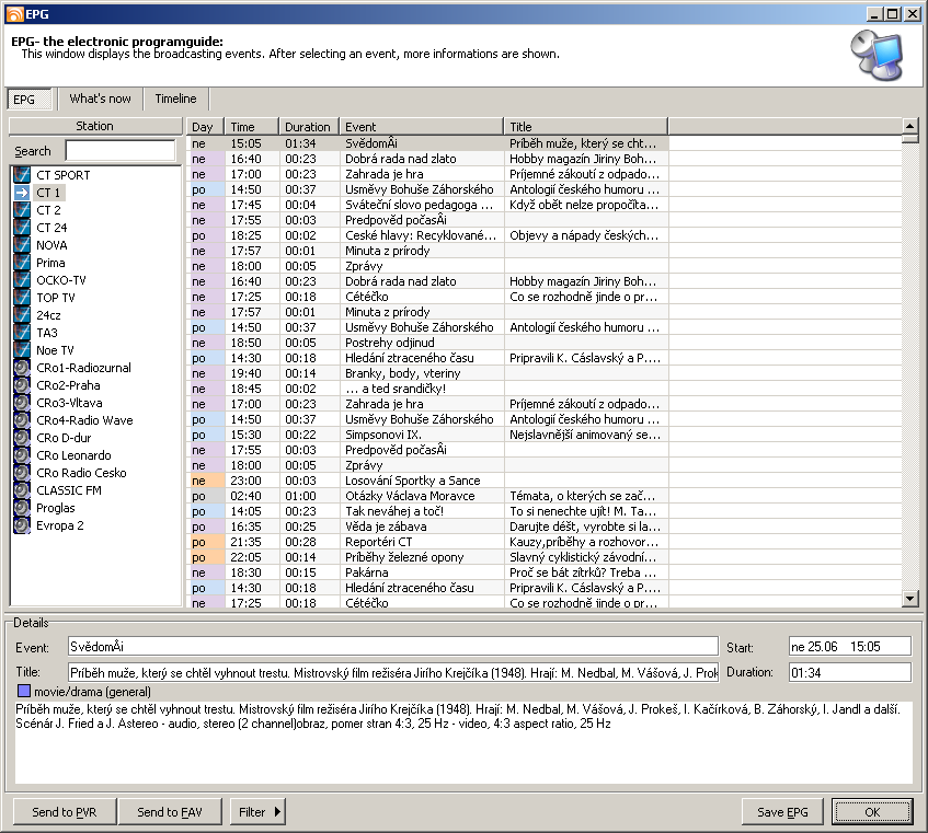

- EPG list is not sorted corretly. There are different days listed in wrong order. Filtering Today does not have any effect. I can provide a screenshot.

Here is the screenshot. Notice that the list is completely unsorted. There are also incorrent czech characters in the Event field, the last two characters should be only one "í".
