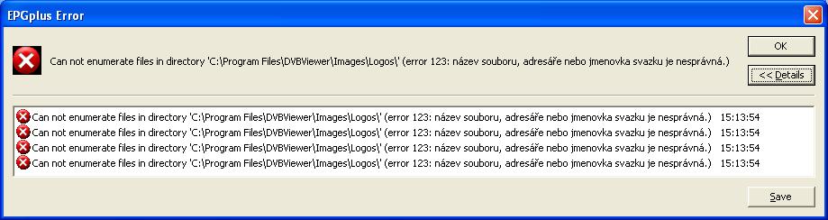

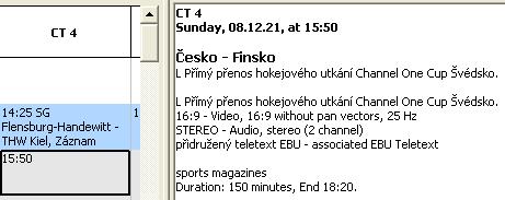

maca_1 Posted December 21, 2008 Posted December 21, 2008 I encountered two bugs. First bug appears when epgplus starts (1). Maybe missing logo causes it? Second bug appears when programme name contains special character (2). Simply no programme name is displayed. Quote
Rayman Posted December 21, 2008 Author Posted December 21, 2008 I encountered two bugs. First bug appears when epgplus starts (1). Maybe missing logo causes it? Second bug appears when programme name contains special character (2). Simply no programme name is displayed. The first bug is known, it is caused by special characters (e.g. ':') in names of your programs in your DVBViewer channel list. Open your channel list and remove special characters from names of your stations. This will solve the first error. The second bug is strange and difficult to reproduce since I dont have EPG with such special charakters. What is it, Czech? Epgplus has been recently adding double entries of programs to record? Was this a one-time phenomenon or is it still coming up with double entries? Best, Stefan. Quote

maca_1 Posted December 21, 2008 Posted December 21, 2008 The second bug is strange and difficult to reproduce since I dont have EPG with such special charakters. What is it, Czech? Yes it is Czech. Only characters with wedge are affected, but there are lot of words with it. There is one channel CT24 broadcasted freely from astra at 19,2. You can try it. CT24.ini Quote

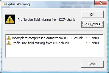

IRa Posted February 22, 2009 Posted February 22, 2009 I start getting followin warning when opening EPGPlus, what might cause it ? "Profile size field missing from iCCP chunk" Quote
Rayman Posted February 22, 2009 Author Posted February 22, 2009 (edited) Hi IRa, I start getting followin warning when opening EPGPlus, what might cause it ?"Profile size field missing from iCCP chunk" I've never seen this error before. After studying arround, I'm sure it comes from one of your station logos! Logos are in PNG file format. The PNG file format supports embedding color profiles within the PNG file. One or more of your logos has such an icc profile. Did you change/update your logos recently? Maybe you are able to find out which one is causing this - maybe it has a different file size than the others? Best, Stefan. Edited February 22, 2009 by Rayman Quote
IRa Posted February 22, 2009 Posted February 22, 2009 Did you change/update your logos recently? Maybe you are able to find out which one is causing this - maybe it has a different file size than the others?Hi Rayman, Yes I was updating logos. Logos are all PNG files but several different size which has never been a problem. Since everything worked OK in DVBV4.0 I removed all my logos from 4.0.10 beta and copied those from 4.0. They worked now OK. Then replacing one by one those which has been changed, now logos are exactly same as when this error message came but somehow now it dissapeared. But I acree it was logo related. BTW is there some reason (maybe for character "&") why one of or channels doesn't show logo even the naming of PNG is OK. Channel name is "IskelmäTV Harju & Pöntinen" there is also channel "Iskelmä" which shows logo OK, so reason is not "ä" Quote

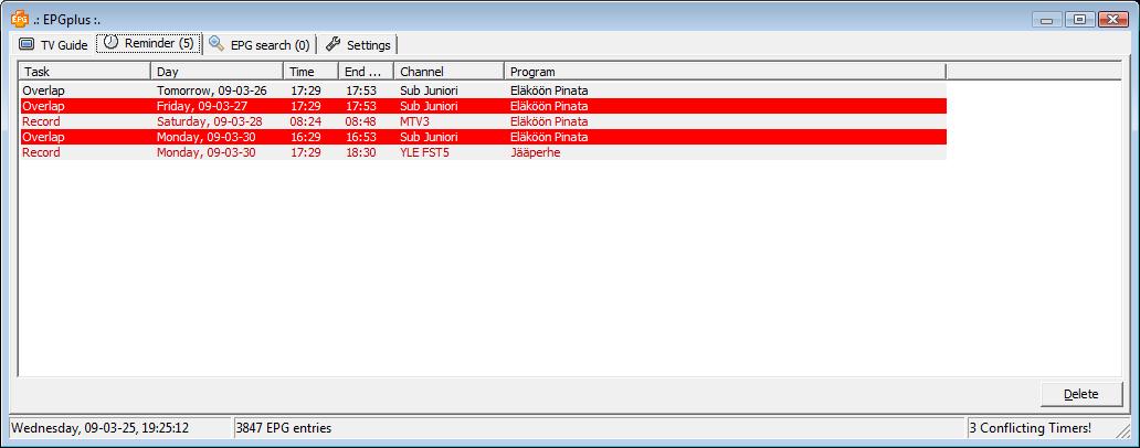

IRa Posted March 25, 2009 Posted March 25, 2009 Important Information: There is still some undefined behaviour in EPGplus due to that time change.Time change is coming soon again !! If I search a program with EPG+ which is coming on next Sunday (after winter / summer time change), EPG+ will program it to be recorded on Monday. Same unwanted behavior still exists. Another issue, I get conflict with timers even there is none Quote

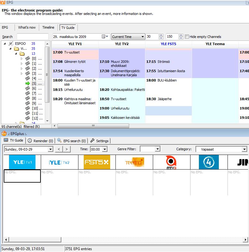

IRa Posted March 29, 2009 Posted March 29, 2009 Same unwanted behavior still exists.Today (time change during last night) EPG+ does not show any EPG data for today, DVBViers does show them OK. They are shown on Monday and after that but Sunday is empty. Quote
Rayman Posted March 29, 2009 Author Posted March 29, 2009 (edited) Today (time change during last night) EPG+ does not show any EPG data for today, DVBViers does show them OK. They are shown on Monday and after that but Sunday is empty. This only happens on the same day when daylight saving time (DST) changes. Obviously, this mistake happens in the date-time-calculations which are done by the GUI framework EPGplus is based on. I've included a workaround which fixes this. It will be included in the next release. Stefan. Edited March 29, 2009 by Rayman Quote
