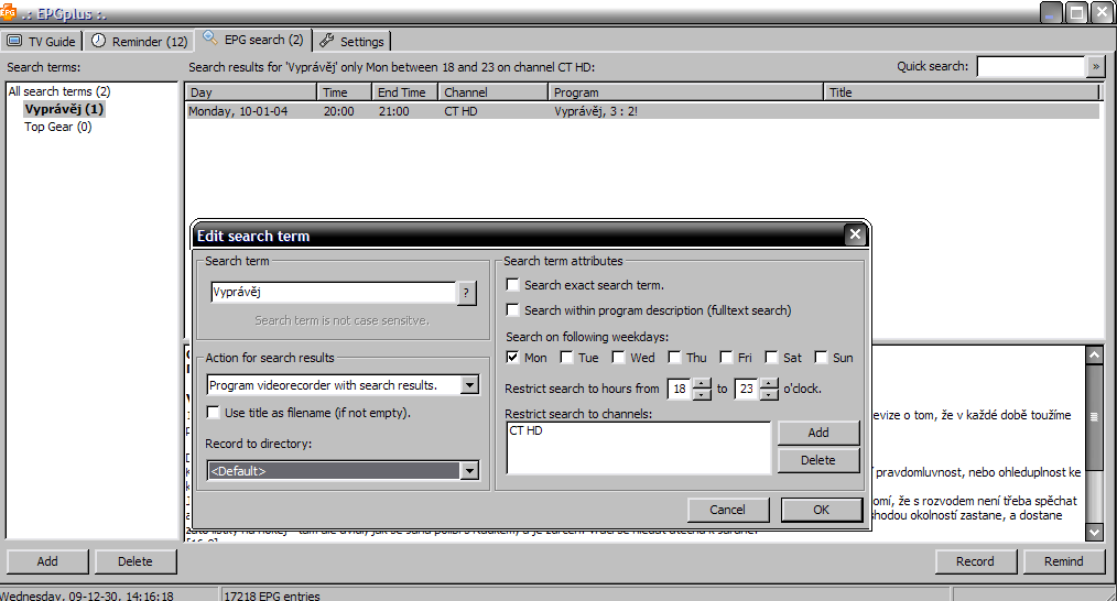

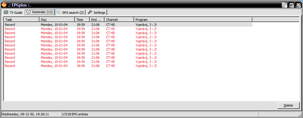

ViViD Posted December 30, 2009 Posted December 30, 2009 (edited) Hi Stefan I found small bug, when new schedule is always added to record window at every restart, or every search. This is probably because of diacritics (in Czech or central european grammar). If tittle is without diacritics, everythings works fine. I added some screens, this problem is because of wrong character (ě -> i), which is inserted to scheduler. (SW version: DVBViewer 4.2.1) Edited December 30, 2009 by ViViD Quote
Rayman Posted January 3, 2010 Author Posted January 3, 2010 Hi ViViD, I investigated your problem but could not yet find a solution. The problem is the diacritics character ě with Hatschek, as you pointed out. Obviously EPGplus is able to find and correctly display words with diacritics. Creating a recording in DVBViewer however causes the transformation of ě -> i. This looks like a problem with unicode characters, since ě is not part of the ANSI ASCII character set. For debugging I only found the czech program CT24 on my stations list - and CT24 only sends a very short EPG, without diacritics characters at the moment - so I could not reproduce your problem yet. Solving this issue might take some time. Best, Stefan. Quote
ViViD Posted January 3, 2010 Posted January 3, 2010 (edited) Hello Stefan. I have one suggestion. You try add small checkbox with option. [x] Remove diacritics from EPG name before send to recorder. I don't now, if is possible to make this, but only idea.... Thanx P.S. problem makes also "ř" -> is replaced in scheduler with "o" other unknown/untested characters in czech/slovak language could be also replaced with other character. Edited January 3, 2010 by ViViD Quote
ViViD Posted January 15, 2010 Posted January 15, 2010 P.S. problem makes also "ř" -> is replaced in scheduler with "o"other unknown/untested characters in czech/slovak language could be also replaced with other character. Stefan> I tested other characters. Almost all chars with diacritics makes problems. (ľ, š, č, ť, ž, ý, ě, ú, ô, ů, ř, ...) This characters you can find at Astra 23,5°E in Skylink/Czechlink EPG channels. (CT1, CT2, NOVA, Prima, Barrandov, STV1, STV2, JOJ, Markiza, etc ...) Quote
Rayman Posted January 18, 2010 Author Posted January 18, 2010 Stefan> I tested other characters. Almost all chars with diacritics makes problems. (ľ, š, č, ť, ž, ý, ě, ú, ô, ů, ř, ...)This characters you can find at Astra 23,5°E in Skylink/Czechlink EPG channels. (CT1, CT2, NOVA, Prima, Barrandov, STV1, STV2, JOJ, Markiza, etc ...) Thank you for your test! I will see what I can do with this issue. Best, Stefan. Quote

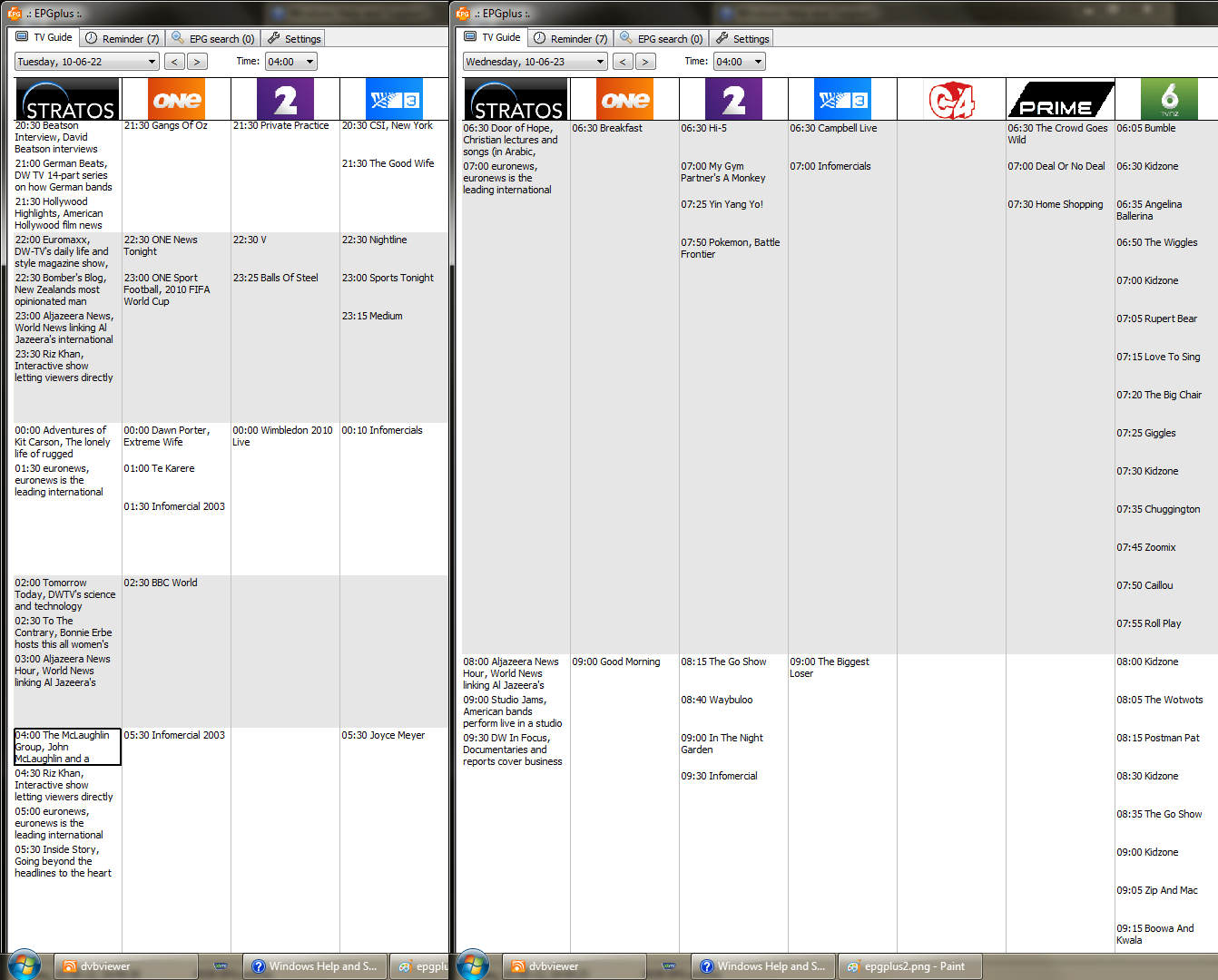

vurt Posted June 22, 2010 Posted June 22, 2010 Have an issue with EPGplus in that it will not display programs starting at 06:00 When selecting the day it shows only programs starting after 06:00 (i.e will show programs starting at 06:05 or 06:30) Have only really noticed due to the Soccer World Cup where the games start at 06:00 and am unable to select in EPGplus See attach screenshot, For stratus, one, 2 and 3 channels all have programs starting at 06:00 thanks Quote
Rayman Posted June 22, 2010 Author Posted June 22, 2010 I confirm this bug! A little strange this issue :-) I will fix it! Best, Stefan. Quote
vurt Posted June 23, 2010 Posted June 23, 2010 I confirm this bug! A little strange this issue :-) I will fix it! Best, Stefan. Thanks, much appreciated. Quote
