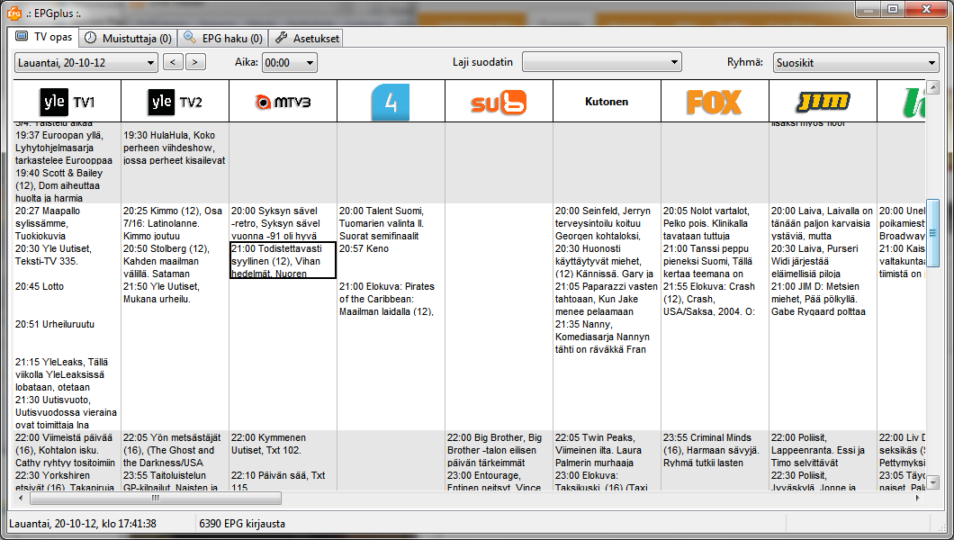

Vellu Posted October 20, 2012 Posted October 20, 2012 I have a couple enhancement suggestions. 1) When you use the TV Guide with keyboard, and there are just a couple of TV-programmes in the channel between e.g. 20-22 o'clock, you can't just go down using down arrow (e.g. like in this picture). To get to the next TV-programme at 22:00, you'd need to go left twice, go down 5 times, and then right twice. It would be great, if you could use down arrow to get from "21:00 Todistettavasti syyllinen" to "22:00 Kymmenen Uutiset". 2) I have a mouse with a clickable and tilting wheel as a center button (Logitech G7). I'd like if the tilting of the wheel to left or right would control the slidebar in the bottom of the window (or the selected TV-programme). Since rolling the wheel controls the slidebar on the right side, it would be logical if the tilting of the wheel controlled the bottom slidebar. 3) Since not everyone has such a mouse with tilting wheel, it would be great if that could be done in another way as well. E.g. placing the pointer over the slidebar on the bottom of the page and scrolling up or down with the wheel. The pointer would stay in one place, as well as the mouse, but the view would change (left or right). It would be somewhat nicer to use than dragging the slidebar on one direction or the other. 4) when you click the tabs in the top of the window, it takes the focus off of the TV guide grid. And if you try to use the wheel to go up and down the grid, it doesn't work. You have to put the focus on the grid by clicking any TV-programme and only then you can use the wheel to go up and down. Similar approach as in item 3: If you put the mouse pointer on the slidebar on the right side of the window and scroll with the wheel up or down, the view would go up and down. Thank you very much for this very useful utility, I like it a lot! Quote
Rayman Posted October 21, 2012 Author Posted October 21, 2012 I have a couple enhancement suggestions. Thank you very much for your suggestions! I will put them on my ToDo-List! I have a Microsoft Mouse with Tild-Wheel and tilding to left-and-right within the TV-Guide works for me: The guide is scrolled left and right (which I use all the time). Maybe there is some special setting in your Logitec Driver? However, I confirm that the focus of the TV-guide is lost when switching between Tabs. I never use the keyboard within TV-guide (since it's so many data and mouse navigation is much faster). Thus, I didn't recognize the behaviour with the up-down-arrows - but you are right! Best, Stefan Quote
Vellu Posted October 22, 2012 Posted October 22, 2012 Actually now that I changed something with setpoint (Logitech's mouse control software), I got the tilting to control the slidebar on bottom. But unfortunately the grid did not move, nor the selected programme. And the up and down did not work at that time (focus was somewhere else). I see the first 7 channels out of 12 favourites, no matter where the slidebar is (when controlled by the tilt wheel). When I move the slidebar by dragging it or clicking the arrows, it works fine and I get to see the rest of the channels. And when the focus was ok, scrolling up and down was ok, but the tilting was similar as when the focus was off (only the slidebar moved). Quote

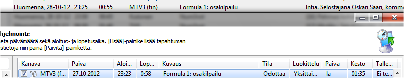

Vellu Posted October 27, 2012 Posted October 27, 2012 (edited) There was a "year 2012 bug" in EPGplus. It is fixed. Please update your version. Download the latest version here. A happy new year 2012 to all board members! Stefan I don't know if anyone else has had this problem, but seems that all the recordings that I've done in EPGplus for tomorrow, are recorded today. In EPGplus the programmes are showing up as they are for tomorrow. When DVBViewer is running without EPGplus, there's no problem. When I start EPGplus, all the programmes from EPGplus are flowing in to DVBViewer and they are shifting to 1 day earlier (at least today, haven't checked them all). Included a picture, where EPGplus was in the background, and the PVR window of DVBViewer in the front. Tomorrows Formula1 race (Huomenna=tomorrow, yes, 28-10-12 is tomorrow), so EPGplus knows it correctly. But when the timer is forwarded to DVBViewer, it mysteriously changed to today (27.10.2012). I also tried to set the timer in DVBViewer's own EPG, without EPGplus running. That timer was set perfectly ok. I don't know if this problem is in EPGplus or DVBViewer, but when they are used together, this problem appears today/tomorrow. It would seem that Monday's timers from EPGplus are on Monday on DVBViewer. But timers that are supposed to be on tomorrow, are triggering today. DVBViewer 4.9.6.20, EPGplus 1.1.2.120101 Patch2 Has anyone else seen this problem today? Is is related to daylight saving chaging next night somehow? EDIT: just a funny notice.. Today's timers are ok. So currently I'm recording 2 different programmes from one channel at the same time. One is correct timer, that is supposed to be recording and the second timer should be recording tomorrow. But they are both on today. The timers are shown in DVBViewer's PVR screen, as they were originally set in EPGplus (Big Brother, Alcatraz). But the name of the files, as they appear in the recording directory are: Big Brother_10-27_21-58-00.mpg Entourage_10-27_22-28-00.mpg Maybe it is more DVBViewer problem after all, but since I remembered seeing some year 2012 bug -statement here, I thought that I'll put this here. And this only appears when using EPGplus (in addition with DVBViewer), as far as I see it. Edited October 27, 2012 by Vellu Quote
Rayman Posted October 27, 2012 Author Posted October 27, 2012 Is is related to daylight saving chaging next night somehow? I currently don't have time to do an in-depth investigation. But changes in daylight saving time are always a little tricky. I don't have differences between EPGplus and the DVBViewer Recordings list for today and tomorrow. You should rely on the DVBViewers Recording list today, since thats the software doing the actual recordings :-) Quote
Vellu Posted October 29, 2012 Posted October 29, 2012 I currently don't have time to do an in-depth investigation. But changes in daylight saving time are always a little tricky. I don't have differences between EPGplus and the DVBViewer Recordings list for today and tomorrow. You should rely on the DVBViewers Recording list today, since thats the software doing the actual recordings :-) no worries It seems that it was just one day. I have a theory, though.. I hope that you can get forward with that. My timezone is GMT+2 normally. During summertime, including the daylight saving 1 hour it's GMT+3. Daylight saving changed on Sunday October 29th in the morning. When EPGplus created those timers, both EPGplus and DVBViewer worked under GMT+3 timezone. But those timers on Sunday 29th were occurring at the time when DVBViewer started to work under GMT+2 timezone. So it may be that neither DVBViewer nor EPGplus are working incorretly as such, but when they work together in situation like that, they produce such a problem. When EPGplus sends the timers that are occurring after daylight saving changes to DVBViewer before daylight saving changes, how does it send them? - daylight saving off (as the target time), gmt+2, timestamps -1 hour, i.e. EPGplus 'converting' the source time to target time, according to target time's timezone) (e.g. current time 28.10 18:00, timer for 29th 19:00 - 20:00, --> timer delivered as daylight saving off, gmt+2, timer for 18-19) - daylight saving off (as the target time), gmt+2, timestamps no change, i.e. EPGplus delivering timer as it was for today, letting DVBViewer notice that it's occurring after daylight saving change) (e.g. current time 28.10 18:00, timer for 29th 19:00 - 20:00, --> timer delivered as daylight saving off, gmt+2, timer for 19-20, and let DVBViewer handle it) - daylight saving on (as the source time), gmt+3, timestamps no change, i.e. EPGplus delivering timer as it was for today, letting DVBViewer notice that it's occurring after daylight saving change) (e.g. current time 28.10 18:00, timer for 29th 19:00 - 20:00, --> timer delivered as daylight saving on, gmt+3, timer for 19-20, and let DVBViewer handle it) - daylight saving on (as the source time), gmt+3, timestamps -1 hour, i.e. EPGplus 'converting' the source time to target time, according to target time's timezone) (e.g. current time 28.10 18:00, timer for 29th 19:00 - 20:00, --> timer delivered as daylight saving on, gmt+3, timer for 18-19, and let DVBViewer handle it) I'm not sure if I put those correctly and what information EPGplus is able to deliver to DVBViewer, but just to give my suspicion, that it gets somehow wrong, because the source timezone (gmt+3) is not the same as target timezone (gmt+2) because of the daylight saving change. I still don't know if it's DVBViewer or EPGplus, which causes the timer to exist on previous day... It could be DVBViewer, if it takes off 1 hour from target time midnight. It would then get 23:00 o'clock during previous day, and then add the 19 hours (as in my example) to get timestamp 18:00, BUT not taking into account that a date changed again... Quote

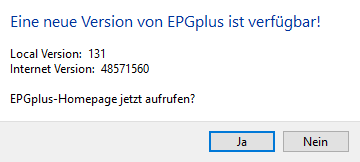

Werrner Sayn Posted April 30, 2018 Posted April 30, 2018 Hi, Folgende Info ist in EPG+ unter Update prüfen. Die HP ist aber nicht erreichbar. Hat sich da was geändert? (Version 48571560 klingt irgendwie unglaubwürdig ) So Long... Werner Quote
Webturtle Posted April 30, 2018 Posted April 30, 2018 (edited) Hallo, EPGPlus ist jetzt im Mitgliederbereich zu finden! Die dort herunterzuladende Version ist 1.3.1. vom 20.01.2017. Viele Grüße Webturte P.S. Vielleicht könnte man auch TimeShift+ dort zum Download anbieten oder die Seite von TimeShift+ überarbeiten. Der Download-Link dort ist echt schwer zu finden. Edited May 2, 2018 by Webturtle Quote

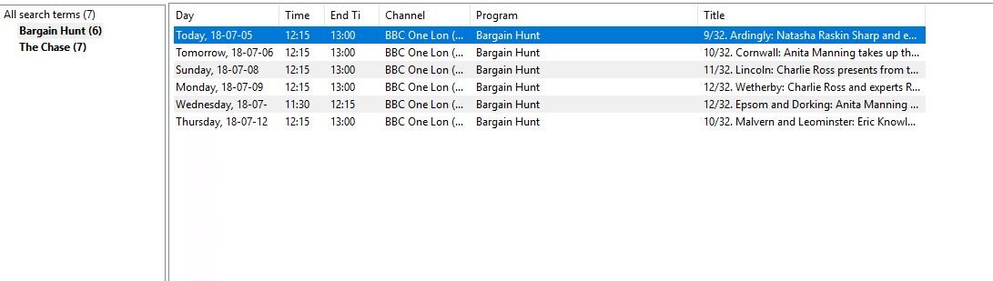

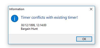

blues-riff Posted July 5, 2018 Posted July 5, 2018 I have recently started to experience timer conflicts when using EPGplus. I search for a program on a specific channel and get the appropriate list as shown below in list.jpg which shows the correct time and date. However when I select one of the programs to set the record schedule I get the error 'Timer conflicts with existing timer' The error description always shows a program date of 30/12/1899, however, if I then select OK the item is correctly entered into the Scheduled recordings list. I have completely reinstalled DVBViewer and EPGplus with the most recent versions but the error remains. The effect of this is that I have to enter each program individually after pressing the OK rather than being able to select the whole list and enter just once. Quote
Rayman Posted July 5, 2018 Author Posted July 5, 2018 vor 6 Stunden schrieb blues-riff: I have recently started to experience timer conflicts when using EPGplus. I search for a program on a specific channel and get the appropriate list as shown below in list.jpg which shows the correct time and date. However when I select one of the programs to set the record schedule I get the error 'Timer conflicts with existing timer' The error description always shows a program date of 30/12/1899, however, if I then select OK the item is correctly entered into the Scheduled recordings list. I have completely reinstalled DVBViewer and EPGplus with the most recent versions but the error remains. The effect of this is that I have to enter each program individually after pressing the OK rather than being able to select the whole list and enter just once EPGplus shows this error because DVBViewer responds with an error when trying to execute this action. Could you please once close EPGplus and try to perfom the same action within the Recordings-Window of DVBViewer? Is there a similar message from DVBViewer? Quote
Vellu Posted March 22, 2019 Posted March 22, 2019 I have the same issue. The timer is added there regardless of the error message. Adding a series (adding a search item) does not produce the error. That's the usual way of how I use EPGplus. There' no error, if (EPGplus is shut off and) timer added from the EPG of DVBViewer itself. I thought that I got it after getting a new computer and reinstalling everything, but seems it's not just me. Quote

blues-riff Posted September 7, 2019 Posted September 7, 2019 On 7/5/2018 at 11:49 AM, blues-riff said: I have recently started to experience timer conflicts when using EPGplus. I search for a program on a specific channel and get the appropriate list as shown below in list.jpg which shows the correct time and date. However when I select one of the programs to set the record schedule I get the error 'Timer conflicts with existing timer' The error description always shows a program date of 30/12/1899, however, if I then select OK the item is correctly entered into the Scheduled recordings list. I have completely reinstalled DVBViewer and EPGplus with the most recent versions but the error remains. The effect of this is that I have to enter each program individually after pressing the OK rather than being able to select the whole list and enter just once. Quote
blues-riff Posted September 7, 2019 Posted September 7, 2019 I have still not been able to resolve this error. I have recently set up a new Windows 10 current version computer and installed DVBViewer and EPGplus but with the same result. Even though this error comes up the item is still added to the 'Timer Recordings'. Adding a scheduled recording from the DVBViewer program guide works fine with no errors. Any thoughts or advice would be much appreciated. Blues-riff Quote
