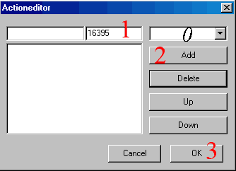

Is it possible to assing PIP to remote control? Didn't find that kind of option.
You can build your own Input command:
  1. Options>Input
  2. Add Group
  3. select the new group
  4. Add (PIP)
  5. in the Actioneditor write 16395 (in 1) click on Add (2) (you can add more than one command)
  6. click OK
  7. click Learn select (PIP) press the button
  8. click Learn
  9. click Save
By the 0 you find other possible commands.
