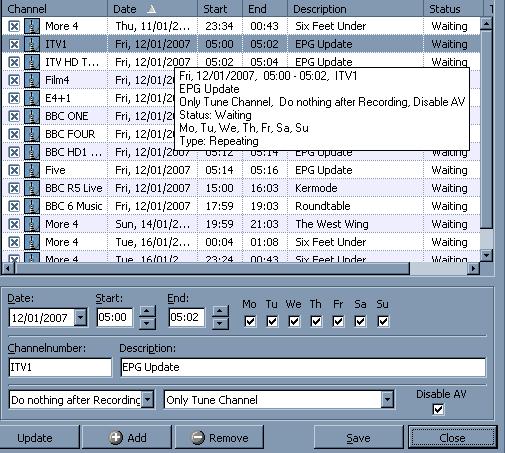

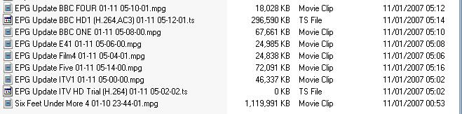

I have several events in the recorder that are set to 'Only Tune Channel' (they are for daily epg updates). The Recording Service ignores the 'Only Tune Channel' flag and records them anyway.
I have attached the support tool zip, a screenshot of my recorder window, a screenshot of my capture dirctory and the svcdebug.log.
To reproduce this bug:
1. Set a recorder event to 'only tune channel'
2. Save and close DVBV
3. Start recorder service (if not already started).
Result: The event records, regardless of the 'only tune channel' flag.
