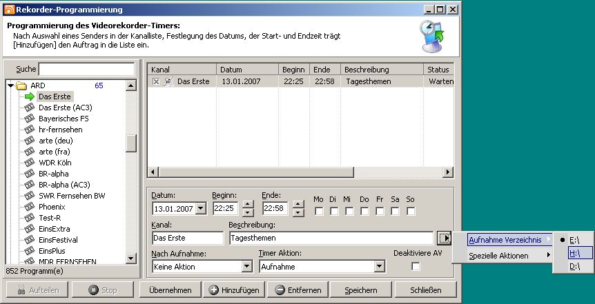

Oh I see, that's fine.
I do have several folders defined in dvbv options, but I can't see any way of sending recordings to them in the recorder window. How would I go about doing that?
Hello,
look at my Screenshot on the right side.
Edit or make a new timer and take the option to define the record-folder.
