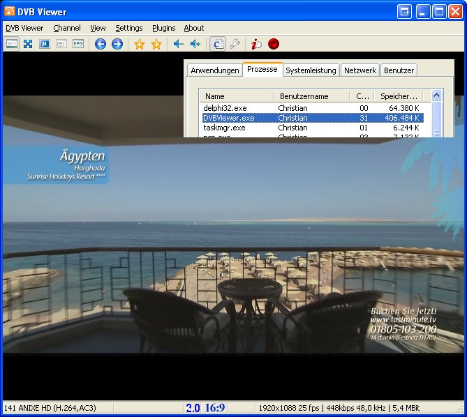

Moses Posted May 7, 2007 Posted May 7, 2007 (edited) with H.264 decoding done all by the GPU you could have H.264 even on very weak CPUs equiped with the right grafikboard... look at that screenshot where a H.264 channel only takes 4% CPU usage.. I think that's a great result. Link: http://www.DVBViewer.info/forum/index.php?...st&p=133909 Edited May 7, 2007 by Moses

hackbart Posted May 10, 2007 Posted May 10, 2007 To be honest i doubt that this performance gap is just caused by EVR. I made a lot of tests in the past and we (Lars and I) honestly dont think to integrate EVR. Especially since it causes more work than it did in the GE. Especially since we render the OSD into a second pin. Anyway i think it is better to keep focus on the work I did in the last weeks: The D3D Solution (http://www.DVBViewer.info/forum/index.php?showtopic=17746&st=45&gopid=135844entry135844). Concening to the speed issue: You have to make sure that both applications are using the same codec - since the differences are huge. Christian
